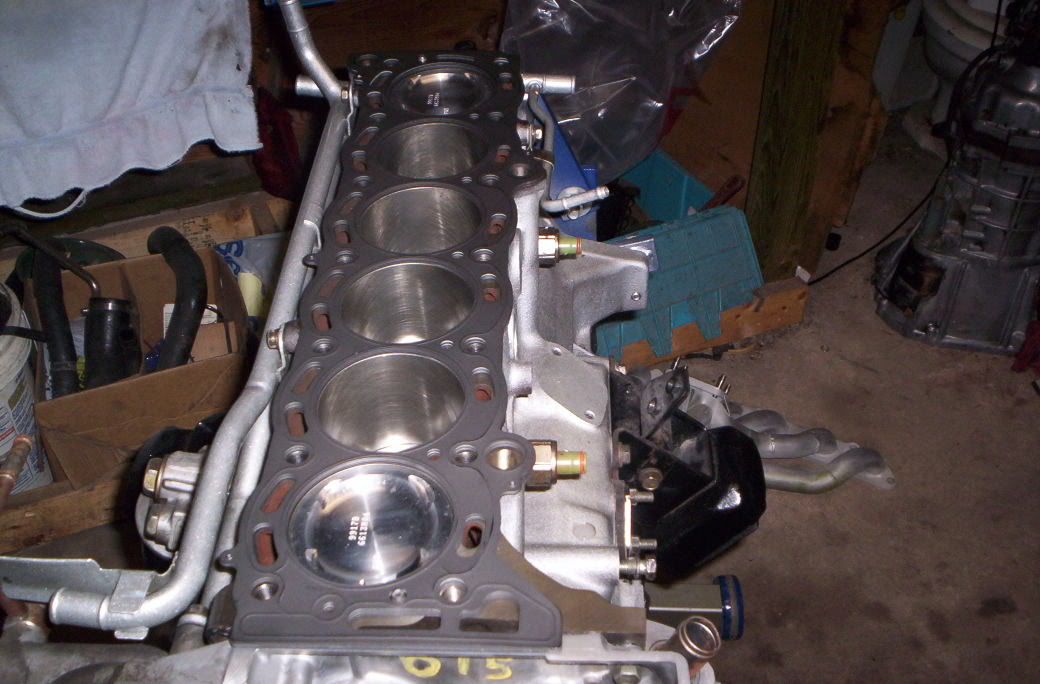

Bare MHG

IJ.;1805737 said:
hmm dont look the same so i guess there is viton on the gasket.
K that answers my question, so basically if it looks nothing like that just install the gasket dry. Gotcha, and man IJ youve got pictures for everything. Ever thought about writing a 7M Encyclopedia and publishing it?
LOL nah been doing this a long time!
