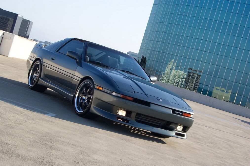

I don't have the Greddy, but I did pretty extensive mods to a stock '89 bumper (see pic). I have a TruCool tranny cooler w/ Spal fan under the drivers side and use the pass side as a cold air intake...didn't want the stock fog lights to block the airflow. So, I used Oplilux (Hella) after market lights here:
http://www.hella.com/produktion/Optilux/WebSite/AuxiliaryLights/FogLamps/FogLamps.jsp
I used model 1600, but there are several rectangle/oval shaped lights that would look good. They are 55 watt housings and I changed the bulbs to higher output PIAA Star White (55 watt pull...85 watt output). I used the stock wiring and did the fog light mod to give me the ability to turn them on without having the headlights on too.
