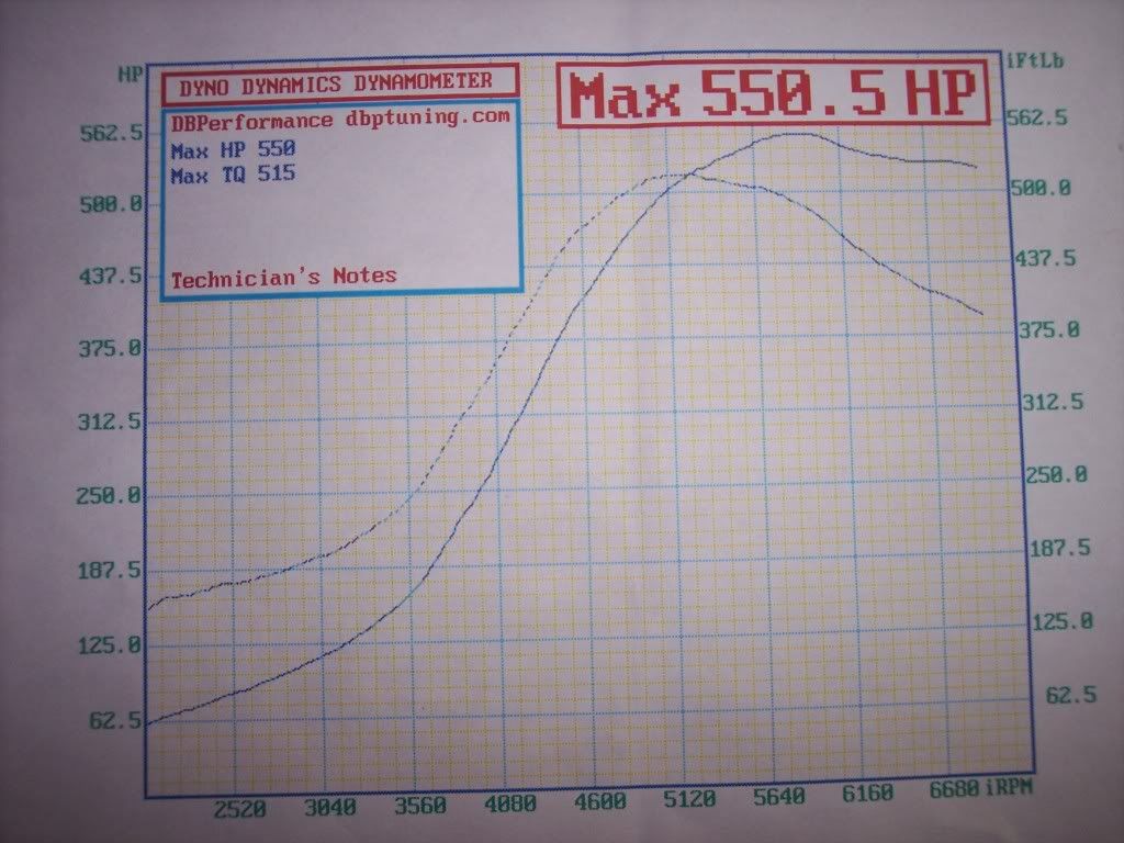

This was with my 2jz and a gt35 DBB, 1200cc injectors and e-85. Boost came on hard just before 4K rpm. We only had 24 lbs of boost to get the 550 rwhp. Now running Comp 67, tbb, with my spool valve, she is very responsive.

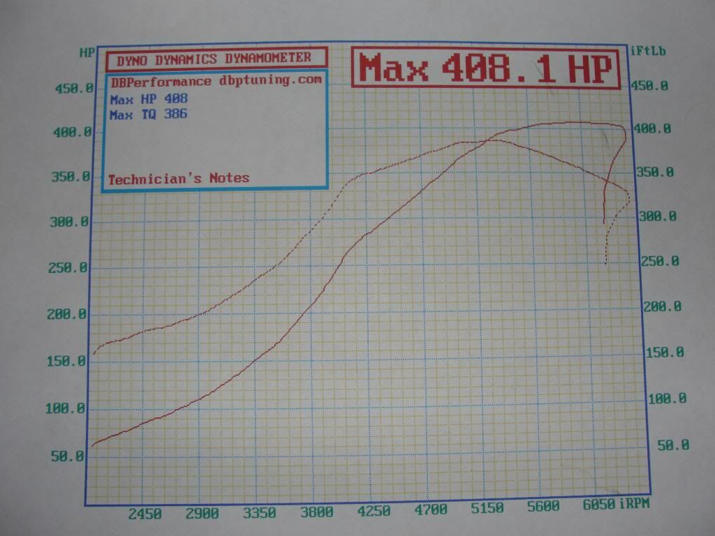

And here's my LIPP BOSS Sr. with 61mm, P-trim, .83A/R exhaust. (gt35R copycat) This was a pump has tune done at 17 psi.
Makes positive mani pressure from 1500, but nothing really noticeable until 3500-3800 when it hits like a freight train. If you look closely at 4000 the wastegate cracks open, which causes a slight jog in the curve.
I'm now running E-85 so it pulls much harder now (+20deg timing helps). Very interested to see what torque I'm making.
EDIT: note Dan's (leecheater) and my dyno locations- these pulls were done at the same shop so they are very good for comparison.
