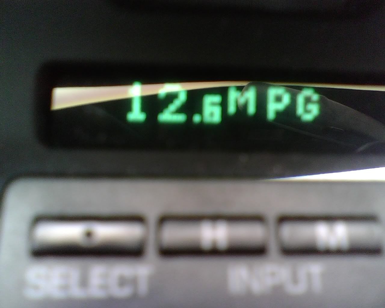

jetjock;1205649 said:
Stop going by the Stupid Monitor for one thing....
:biglaugh:
I never went off my SM when I had my 86.5. It was always lower than what I actually calculated and this was even on a stock fuel system. But yeah, the SM is only good for reading codes.
My sisters 82 L-Type had a "Trip Computer" and it was always spot on with the mpg.
