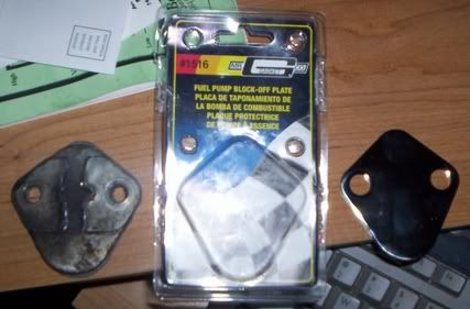

Hey guys, Well as I was doing the finishing touched to my bottom end for my supra, I was wondering why Toyota had a spot for a manual fuel pump on the block and a lobe on the oil pump drive. Did they every use it? Also cause I am running Aeroquip lines I wanted to replace the plate with the fuel return tube. I was going to order the one from suprasport for 30.00, but when I visited the local speed shop I saw one for a ford that was chrome for 7.99. Sure as shit it was exactly the same size as the one on the supra, same bolt holes everything. So I bought it an it fit perfect, a very nice clean look, much cheaper then the one from suprasport. Here is the part # if you guys are interested.

Guys just Grind the tube off the plate and you now have a free block off plate. :dunno:

grinding or leaving it there is just fine. But you can get them thru Mr Gasket @ Oreilly auto parts. Normal cost like 5.50 at the most iirc.
If you are like me then get it for the final touches. not expensive at all and it looks great.
u might be able to see the part number in this picture. part # 1516 FTW

The only problem I found with the one from Mr. Gasket, is that it is a lot smaller in width then the size of the one from Toyota, were as the one from Ford is exactly the same.
