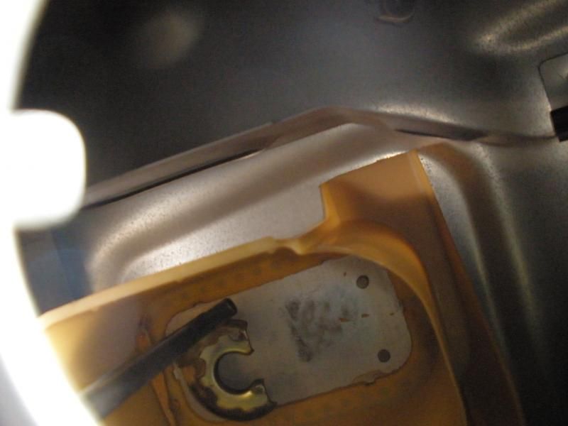

Hey fellas, I searched for pictures on our fuel tank internals specifically the baffle where the pump sits and couldn't find clear pictures. If anyone has a extra fuel tank sitting around, a couple of pics would be appreciated. Basically I'm trying to figure out if our fuel tanks baffle allows for dual pumps to be mounted opposite the bracket as opposed to side by side like this mockup picture below. Long story short, I have a walbro 416 and an E85 AEM fuel pumps. I had the walbro first and know 2 of them will be a mission to fit side by side. I'm trying to work with what I have instead of selling/purchase a second AEM pump etc. they will be staged anyways and the second pump is mostly just for redundancy. Does the baffle allow for such configuration? Thanks

You might not be able to fit both pumps through the tank like that, its a tight fit with the pumps side by side as it is. Otherwise, I think I have some pictures on my home computer, I'll check when I get home tonight.

No way a pump is fitting on that brackets' backside lol darn it. Great pic. Thanks a lot. How important is that plastic baffle? If one is carefull with fuel level etc? Can it be removed? What's its real purpose on our car?

Its there to keep fuel around the pump under hard cornering/acceleration, so I wouldn't recommend removing it regardless of how full you kept your tank.

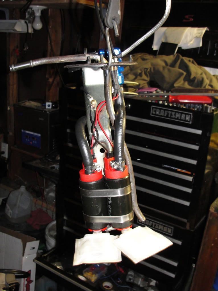

Fitting dual pumps in the tank with the stock hanger isn't impossible, but you have to be very careful in how you attach them to the hanger and how you install the unit into the tank. I have dual Stealth 340's as well, both of which fit into the stock basket. To ensure proper fuel supply to the basket below 1/2 tank, I augered out the feed hole at the bottom of the basket to about 5/8".
Fitting them into there is a royal pain, and clocking them so the pickup socks don't get kinked is also difficult. This is what mine looked like before install:

Thanks for the picture toyotanos. I which we had more options when it come to fuel pump hangers. I'm not sure which pumps Beech's hanger can support. I'm even considering pulling the fuel tank, make the pump bracket hole larger and modify an MKIV aftermarket anger to fit. The MKIV hanger looks to be longer and mounts differently (no direct bolts like ours), can anyone confirm? I have all the resources at my disposal to make those types of modifications. But is it worth it? and would it work is the question. MTR had a nice billet option back in the walbro 255 days, but in limited production.
