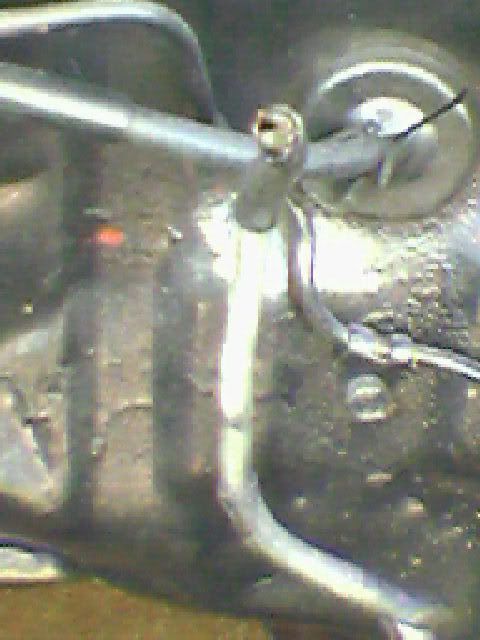

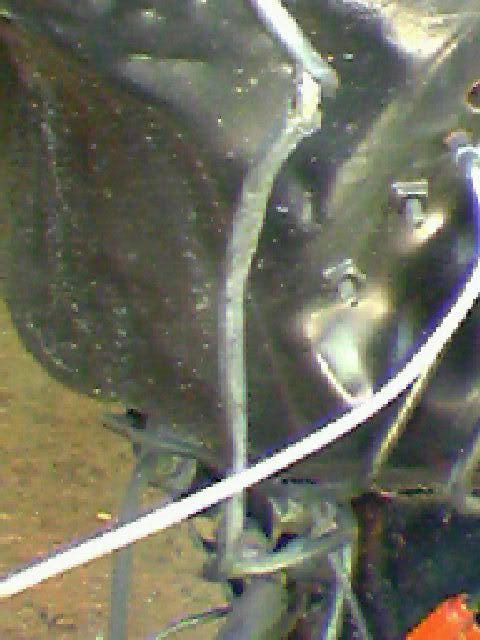

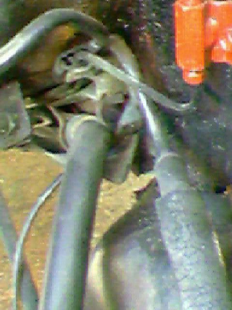

where is it broken? It runs from the fuel pressure regulator to one of the hard lines running to the back of the car.

its broken by where the heater comes out of the firewall. Wich line out of the fuel rail? Theres the one for the fuel pulse damper, the one to the cold start injector and the one for the fuel pressure regulator. those were the only three i had befor.

no sir, you are mistaken, the line of wich i speak is the fuel return line. i got a picture on my phone that i'll upload when i get home... how do i still use the fuel return line if i have an aftermarket fpr?

Ok. Thats my broken line. Its not to or from the fuel pressure damper or fuel pressure regulator. Anyone got any idea's?
