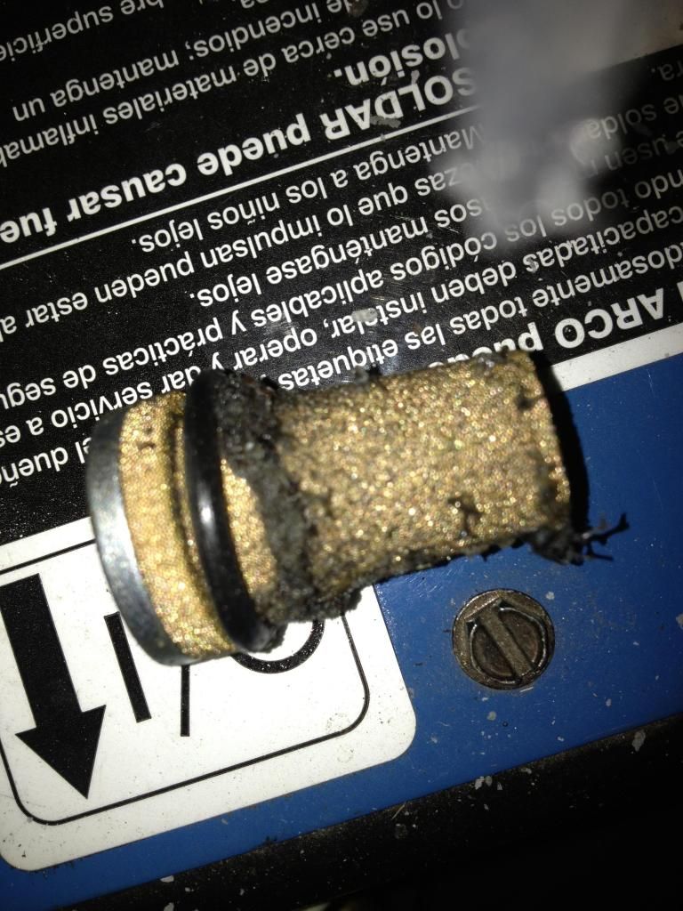

It was fuel starvation. Clogged fuel filter. Note to anyone using fuel cell foam, get a spare filter and switch it out after the first couple weeks. As you see in the picture just build up of particles of the new foam. I was running a pretty small inline filter so didn't take much to clog it. I went ahead and switched to a bigger filter.
