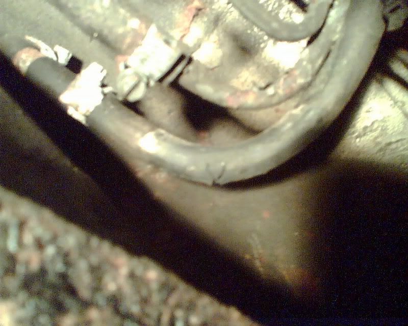

guys ive been busy today, i had a look at my fuel leak so as to get my car mot'd. This is what i found:-
the knackered pipe is clearly vissible. i removed it and got some new pipe the same size. its fitted now but i want to know if it is normal for these cars to have rubber pipes up to the fuel filter? as on the filter itself there seemed to be a sleeve next to where the pipe went in. The rubber pipe i removed was over this sleeve so i just pushed the new bit on to make sure.

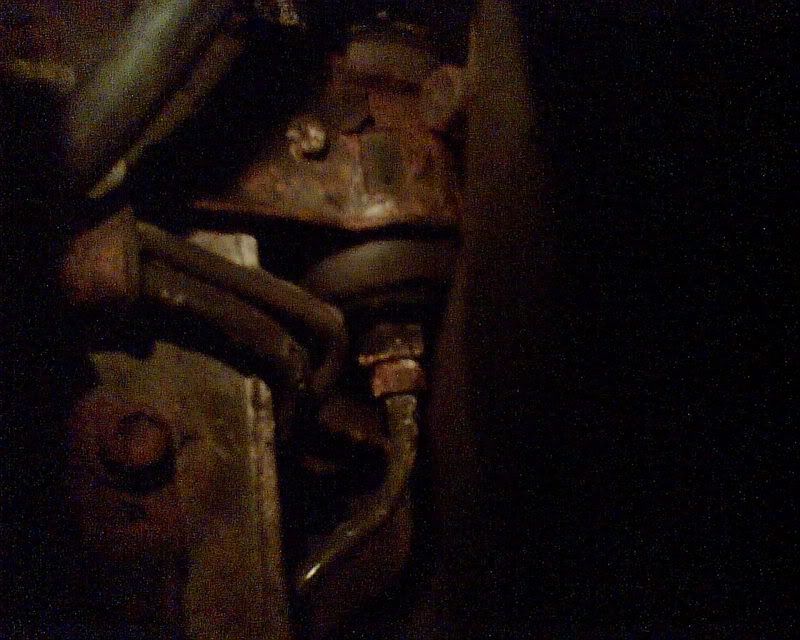

also, my filter apears to have been changed at some point:-
it looks too clean to be original do you think?

nah its the big black rubber pipe. the crack is vissible on the bend in it. the metal pipes seem ok. if i moved the rubber pipe petrol oozed out of it. Ive replaced the rubber pipe now. just waiting for daylight tomorrow to go and fasten up all the clips
