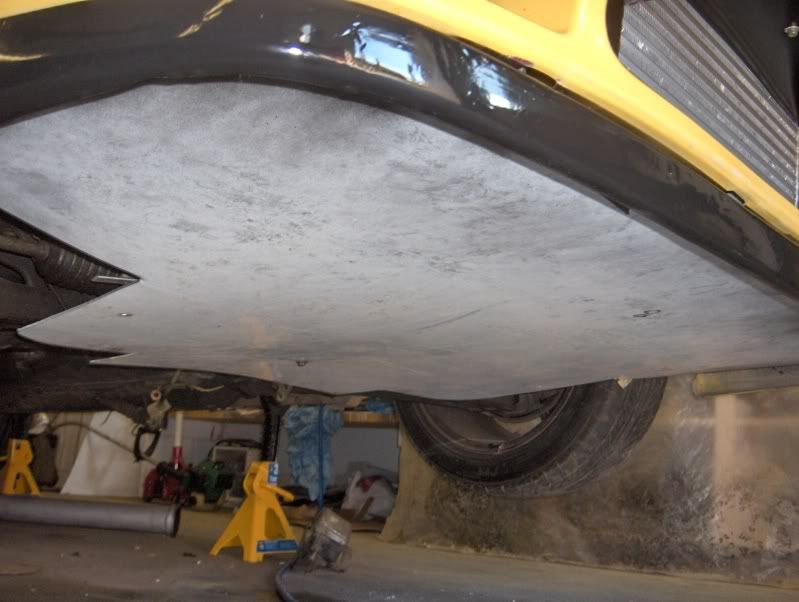

Are you refering to a engine under cover or an actual front splitter they are different items a front splitter extends past the front lip the under cover does what it sounds like covers under the engine and keeps tubulant air under the car the factory one works great at higher speeds I have driven my car with and without the factory unit(until it got torn off) every Supra should have one anyways heres what I did I made my own out of puck board, If you are reffering to a real splitter the same Idea appys only it extends past the front lip and is adjustable for real track use
You will have to use a stonger material for a front splitter Ive seen plywood used
