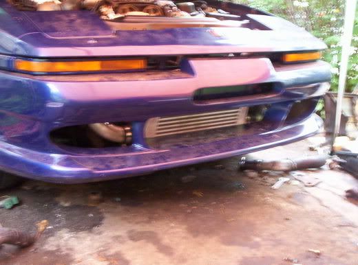

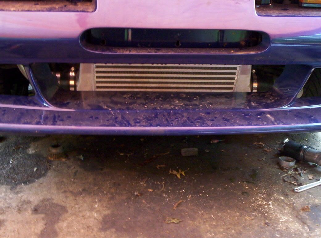

supratkfy
78
San Francisco
pic of the mounting process.....its an ebay core bar and plate, similiar to that of the Megan....could have went with a bigger one but i'm happy with that since i'm not aiming for HIGH hp...
i need to get pics of my car with the bumper on...also i cut the grill in the front off so it shows off the IC...i only did it since my bumper was cracket and the grill was half off already....
