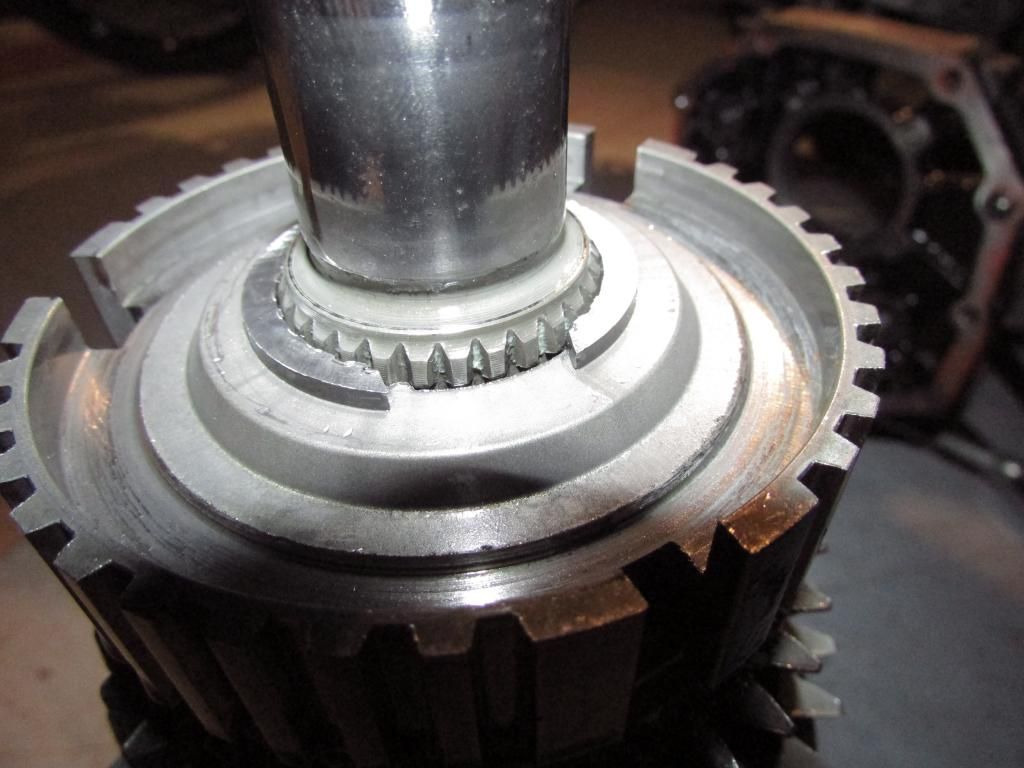

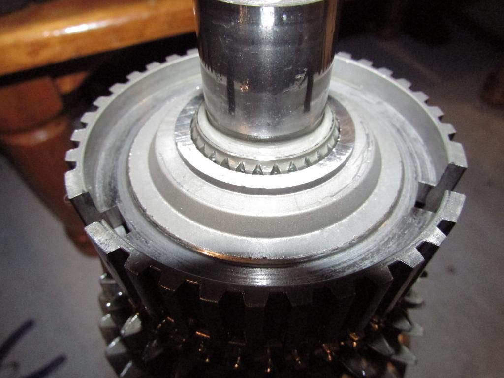

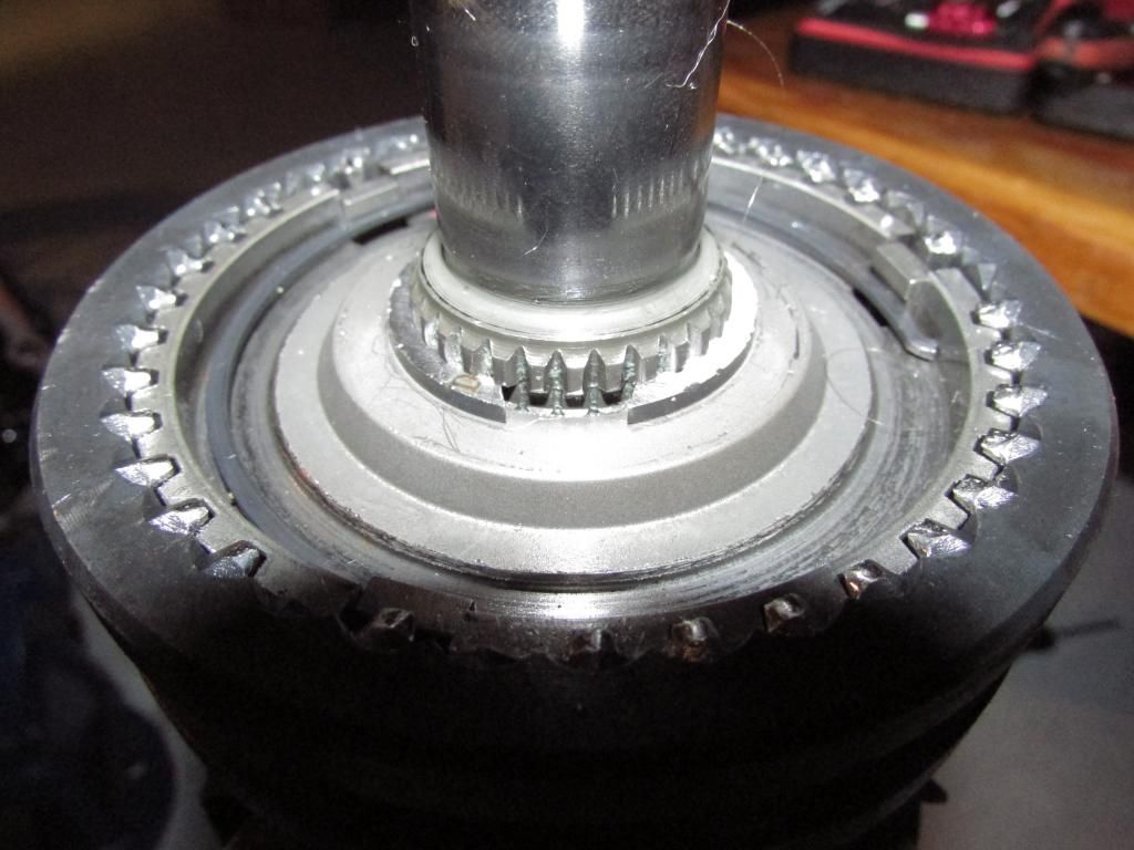

Alright i tore the box down and didnt immediately see anything wrong, but as soon as i had the main shaft out of the centre case i saw one of the snaprings had come loose and moved the gear a couple mm up the shaft.
New clip where it should be. I made sure i hit this inward every couple mm to get it in deep.

Save yourself from repeat failure and buy a new snap ring...
Piratetip
Far From Maddening Crowds
Super Moderator
Dec 30, 2005
1,177
69
MKE, WI
If that's the case, then did you find the root cause as to why it came out of place?
Aleo24
Aug 15, 2011
71
Perth
Hard to say, it has tooth shaped dent on one of the open sides and not the other which makes me think it may have been a little too thick and not seated properly. The one currently in is one size smaller and was as tight to get in.
