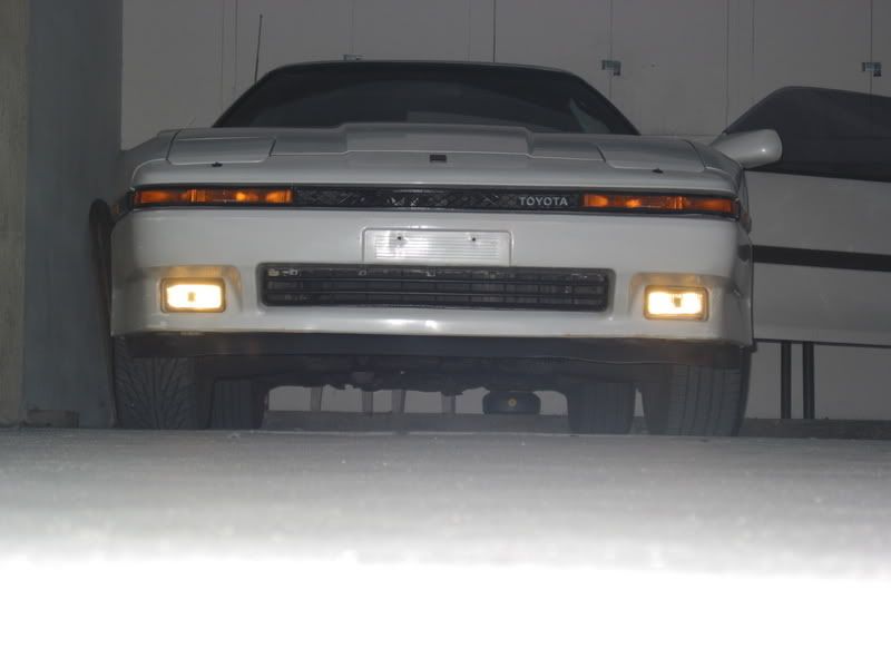

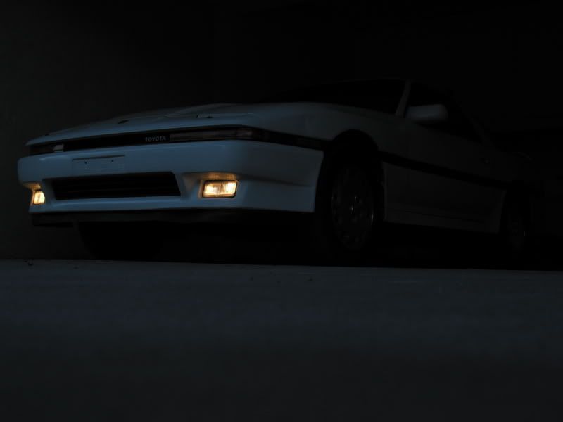

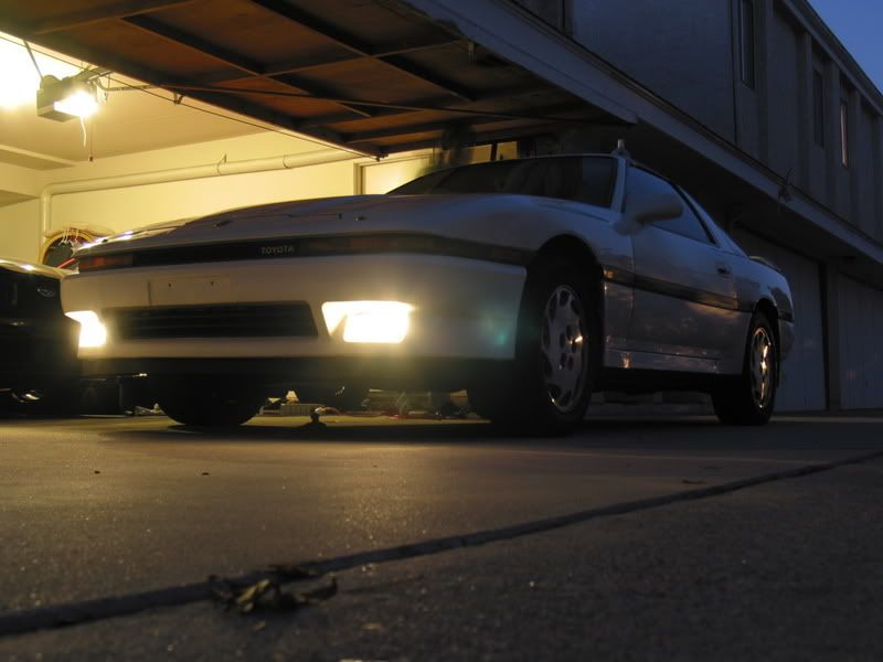

I have the 55W Luminic's Yellow Bulbs from eBay, they are okay, but they seem a little bit underpowered to me.
Here's a pic:
That pic sucks...here are some I just went out and took especially for this thread :):

You cant just install higher wattage bulbs. I believe 55w bulbs are what the wiring and fuse system were desgined for. If you want to run higher wattage bulbs in stock lights of any kind keep in mind the Heat they generate may melt things, the power they draw may blow fuses and toast wires.

Johnathan, have you driven with the yellow bulbs in rain or fog yet?, I have used the 55w ers in all my fog lights over the years and thats where they really come alive since yellow light passes through water droplets unlike white light which bounces around the inside of them before exiting.
