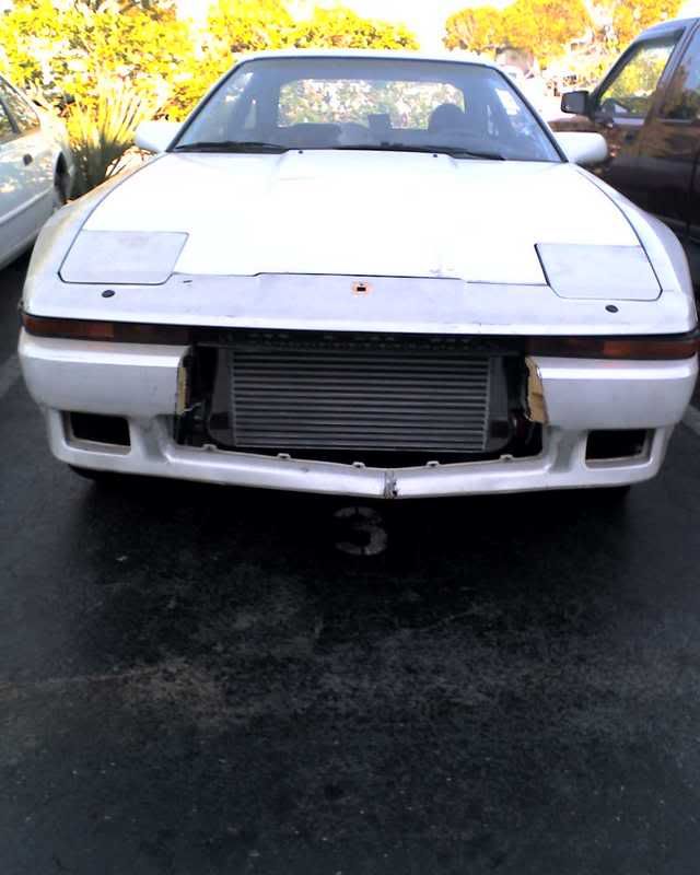

im running 31x12x4 all i had to cut was the support for the horns and get a different radiator overflow.

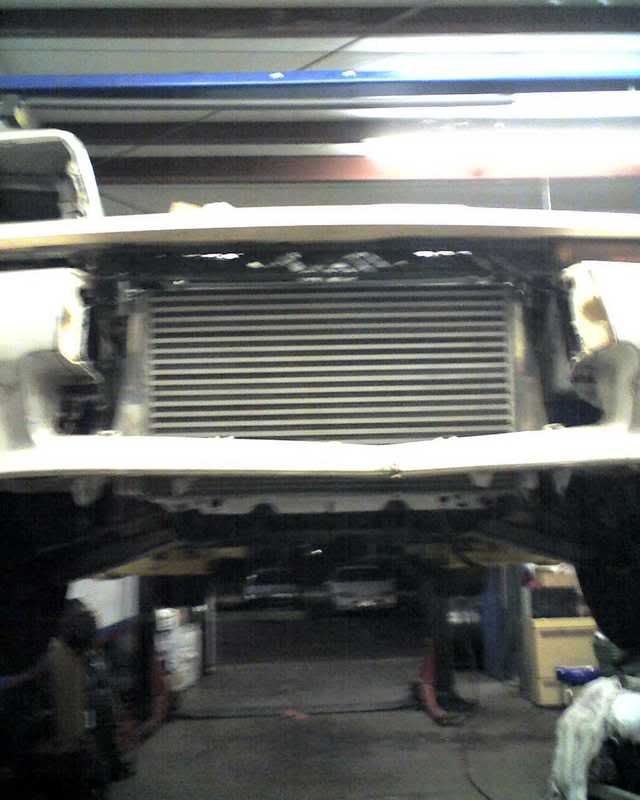

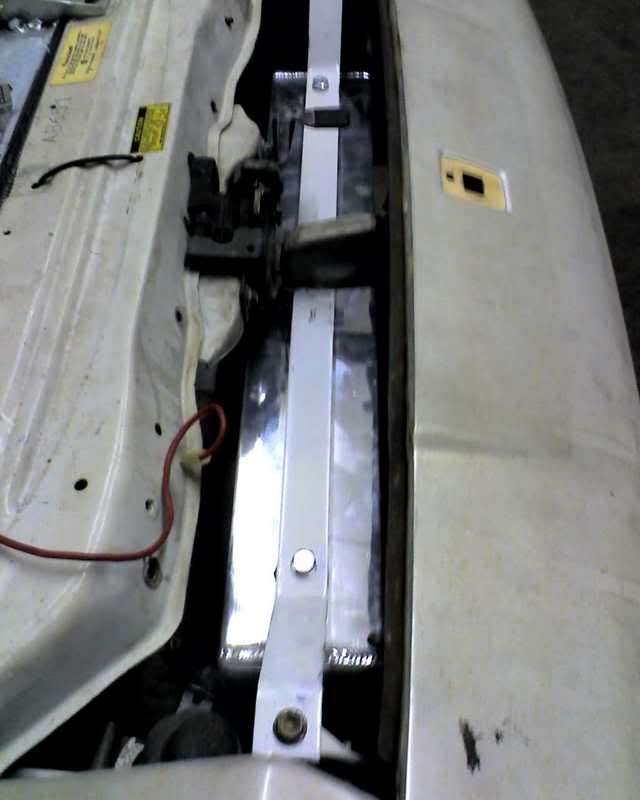

IETV8S said:
wut did you have to do with the hood latch?, pics?
attachment.php
attachment.php
attachment.php
No pics of the hood latch brace, but I will try to get some soon. They were fabb'd by DriftMotion when they had my car....

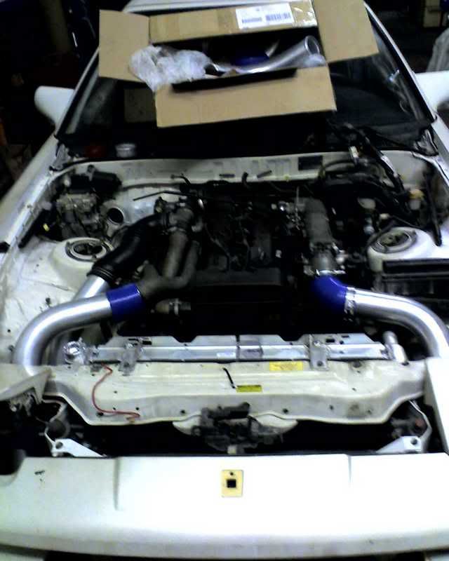

I thought I would attach the pics of the IC itself.

I did mine just like Mark's was done, only I welded the support brackets to rest on top of the frame rails. I modified my hood latch by removing the bracket, and passing a steel zip tie from the hole for the bracket, and running it to a hole behind the nose piece for the bracket.. it keeps the latch from moving up/down.

well im just glad i didnt really have to cut into my bumper support. Just that outer lip thats pinch welded together. I had to drop my tow points also, but i found a way not too long ago to keep them and pipe around them.
