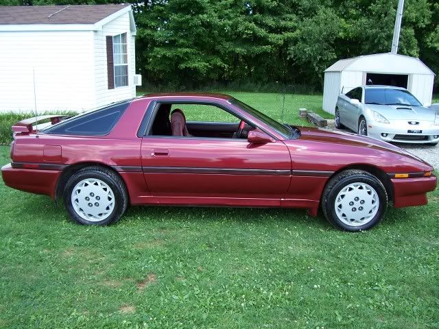

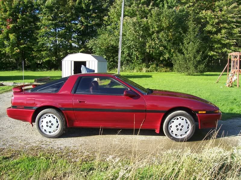

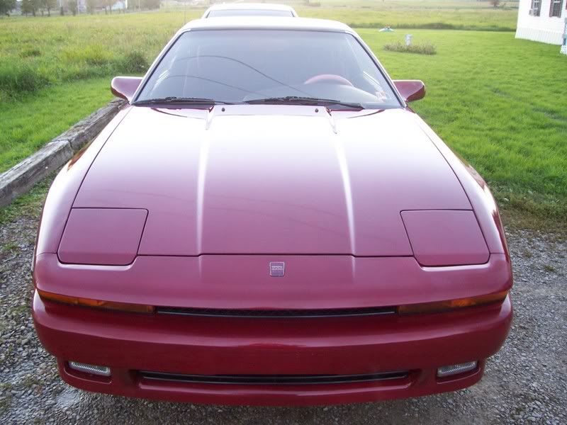

I finally completed painting the Supra. I never tried painting a car before, and I ran into a few problems along the way while learning, but overall it turned out pretty well. I had discovered this spring that both my fenders had rotted out at the bottom, and I had a rust area over the pass side wheelwell, that ended up being a hole when I fixed it. So I got a couple fenders from Tubbie (thanks again!) and got to work. Here's a few pix. Its not perfect...there's a couple small runs in the clear I need to cut out/sand/buff, and there's some dust in the paint, but not a lot. The original paint had been touched up on the front bumper because the dude ran over his toolbox, so I had wanted to paint the car from the day I bought it even before the fender problem. The quater panel was bubbled under the paint when I bought it.
Let me know what you think! (don't laugh at the antenna, it's coming off. I just need to yank it outta there so I didn't bother covering it)
Before:
Fenders rotted:
New fenders, and body work:
Paint bay:
Finall result:

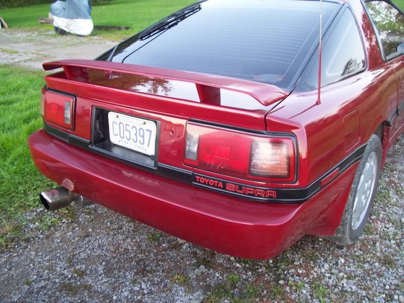

Thanks! It's not perfect, but for a first try I'm happy with it. I had ditched the original moldings, put on the 89+ and repainted them (with Krylon) the TOYOTA SUPRA I did with a paint marker (like for modeling). I also replaced the mudgaurds as the 87 ones had the same problem as the molding (metal support rusting and warping).
The paint is the original 3h1, only in metaflake, and the paint brand is Matrix System. It laid down really nice.

I don't know what kind of compressor it was, it was a big floor model, old. I painted it at my sister-in-laws boyfriends step-dads (Phew!). The gun we used was a Binks pot set-up. We had a HVLP gun as well, but we couldn't get it to lay down as nice. Always wanted to "dry spray". The bimks was real nice with so many pressure adjustments, etc, but I had to watch, it had a tendencie to want to drip randomly. Kept the gun at 20 psi and adjusted the volume and fan from there.
