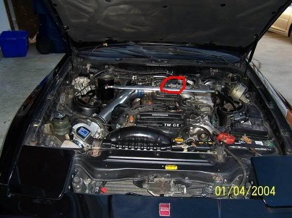

clean all of the intake ports out. There tends to be a lot of carbon cake up in there. I usually just scrape it out with a screwdriver with a vacuum over the port. I'm talking about the little cover on the top with the 4 bolts as the following picture shows.
