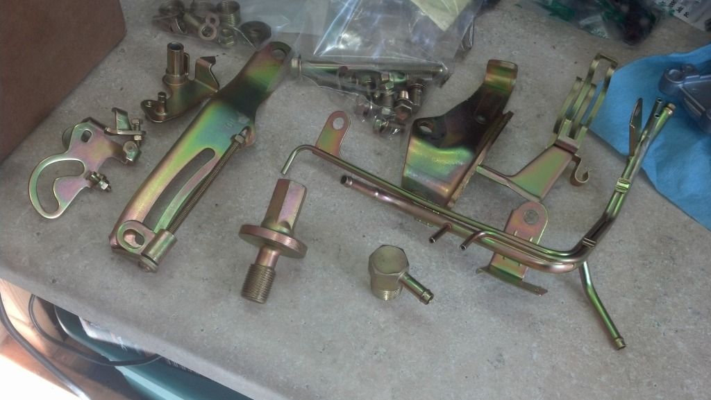

I had a bunch of my stuff re-zinc'd, because i do like it.

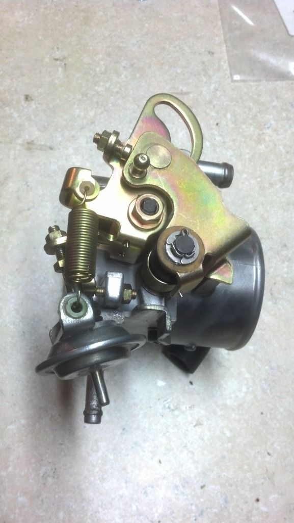

Yeah, it was zinc chromate plating. I had it done at a place called Metal finishers of Atlanta - MFA.
They do all kinds of plating, including gold, chrome, and anodizing in colors.
It cost me $150 to have all my stuff done. Their minimum charge is$100, + $50 for setup(clean, and wire lace the parts).
I could have had more done for that price, but i didn't have any more stuff to be plated at the time.
See my build thread for a few more pics of the parts.
