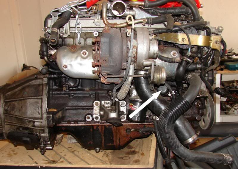

Here is a good picture of where on the motor it is, and what to look for. That rubber boot covers over it, and it houses the harness plug. It is much easier to access from underneath the car.
Your story is sounding like Supramania can definitely help you! You should research here, and ask questions before ever taking your car to a F-chanic. Many things with this car sound difficult, but are very simple to do with the help of those who have done it all before. Don't be afraid, we were all there before. I personally was just as green with my first Supra. Now there is very little I can't do without some helpful knowledge.

If it worked before, and not after, chances are that It's still unplugged IMO. I'd check the connection before buying another.
---------- Post added at 11:45 AM ---------- Previous post was at 11:43 AM ----------
BTW, here's another pic showing it.
