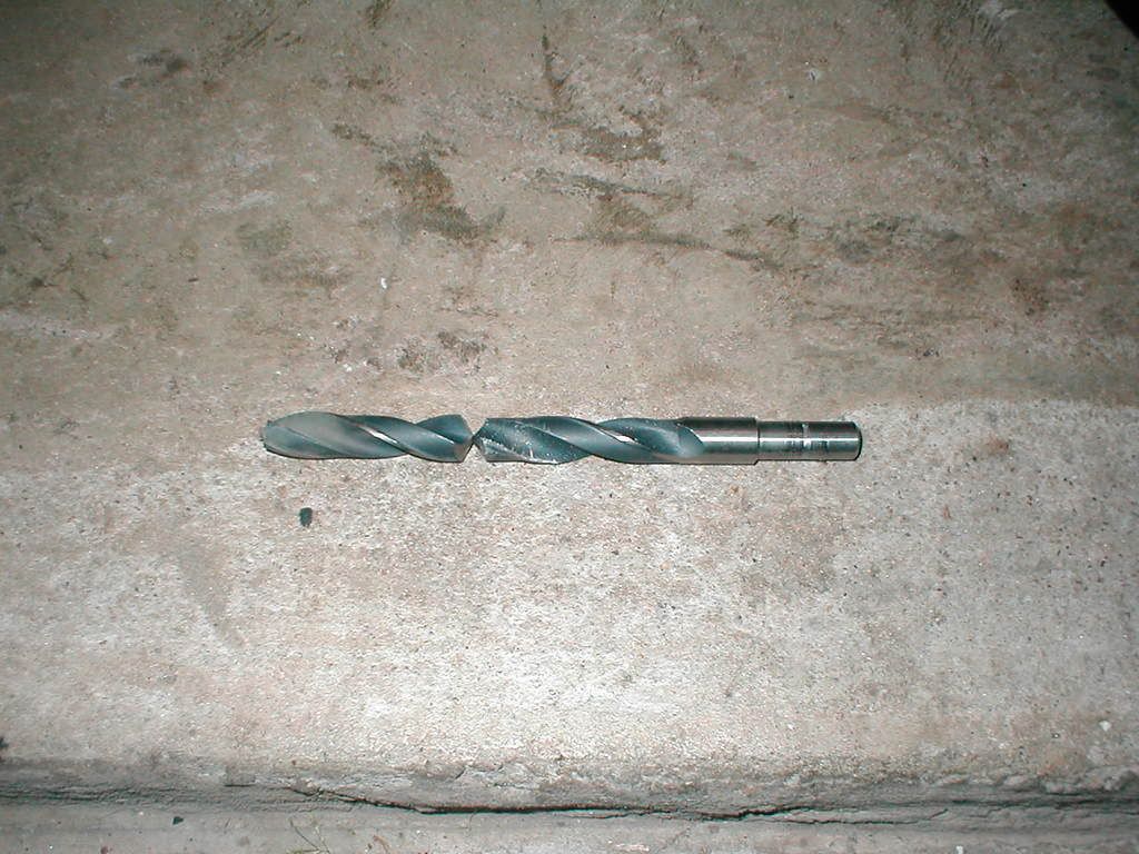

I had to do this fairly recently.
I used the stock size and they stripped back out when I went to torque em. So I had Aaron overnight the larger set.
I have a Drill Dr. so I just cut the drillbit (WEAR EYE PROTECTION, my glasses are polycarbonite and are classified as such and SAVED my eye) and resharpened it so I could do the hole as the back of the head.
Couple evenings? I had it done in a couple hours (but I've had the engine apart many times and know how to put it together very quickly).

How short does the bit need to be?
I'd started doing a little more research and decided I need to ask Aaron about getting the kit minus the bit anyway, but your bit looks extremely short. I think the shortest I found on a quick search was a 5 5/8" for a 3/8" chuck.
I plan on just going to the local hardware store and picking up a corded drill, bit, and 90 degree, then using the DM kit for the studs/nuts/hc/tap.
