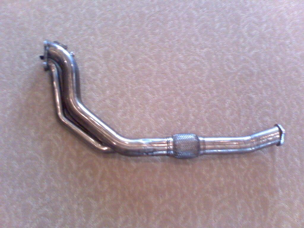

hi
i was wondering if i should buy this down-pipe from eBay and if it is really worth it or if any of u guys have used one...also what is the purpose of the bottom pipe being cut off half way..does it improve performance or just sound....i really need some feedback on this item from u guys..it would really help me decide to buy it:
http://cgi.ebay.com/ebaymotors/Toyota-Supra-7mgte-MK3-86-92-Downpipe-Split-Dual-Flex-_W0QQcmdZViewItemQQhashZitem1e5eda2912QQitemZ130440374546QQptZMotorsQ5fCarQ5fTruckQ5fPartsQ5fAccessories
Also my car is a 1991 Toyota Supra turbo(stock CT26)
Thanks a thousand,
TheMafyoz
FullNelson
Sep 17, 2007
574
Coastal Georgia
When the smaller tube is redirected back into the exhaust its because it is quieter than having it left open. Alot of guys have said they changed back to the re routed style later because its too loud.
Also, for that pipe to be effective, it needs a small tab to protrude from the mounting flange. this tab separates the wastegate gas from the rest of the exhaust. To see what this tab is, look at the BIC downpipes where it mounts to the turbo.
I have a very early version of that downpipe, and it has the tab. Newer versions without the tab don't work at all and I've told the vendors on ebay that several times...
