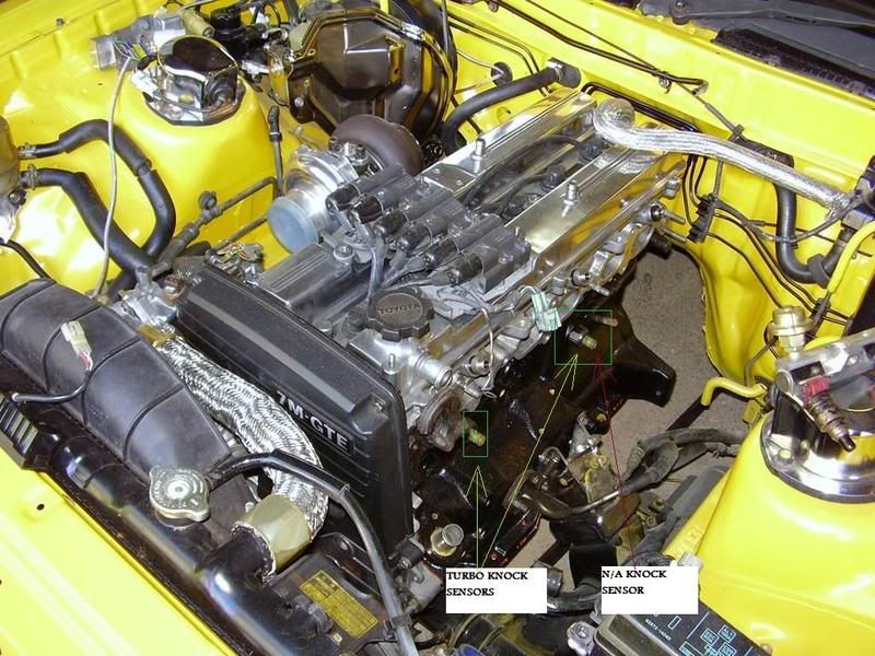

Do you a further description on where the knock sensor is placed? Is it visible in this pic?

As for code 52 (knock sensor) location
here's a picture I got while back I had the problem with code 52 to, there are two for 7mgte and 1 for 7mge...
