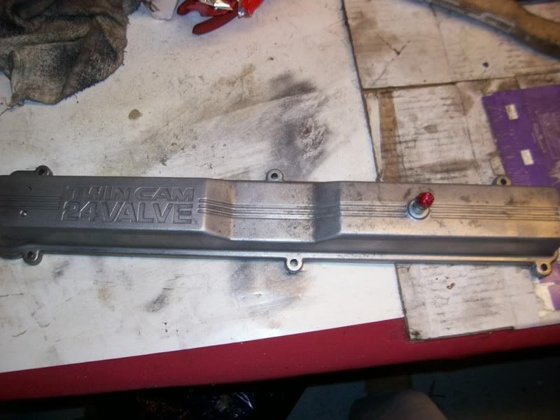

I start out by removing the paint and dirt.

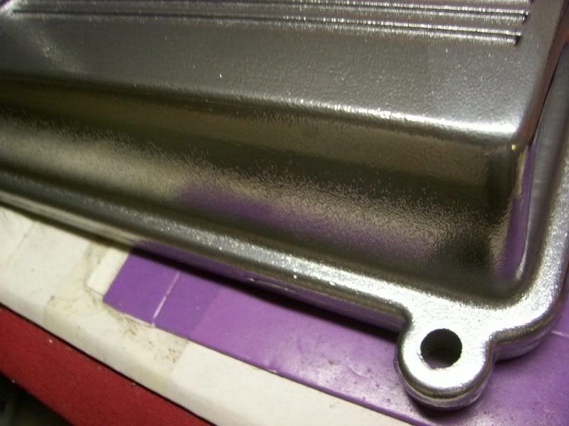

One in chrome

Valve Covers and Fuel Line.
Removed Paint
A lot of cleaning.
Sprayed on the Chrome and cooled

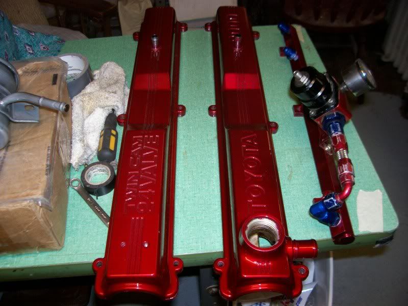

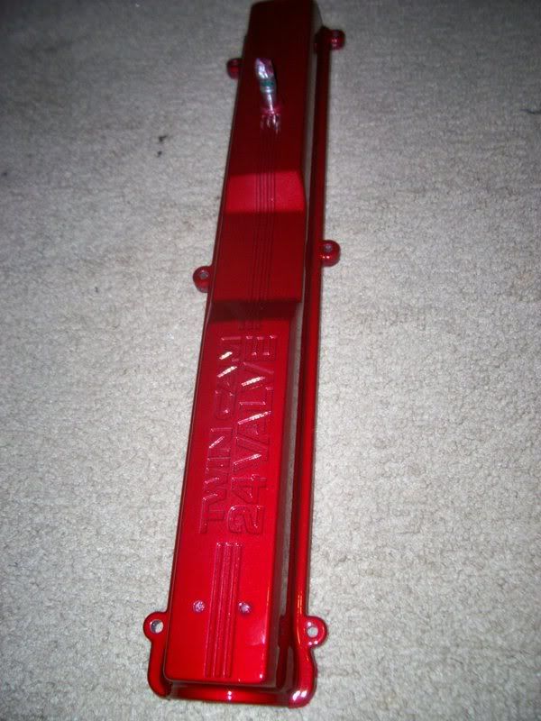

Sprayed on the Candy Red
Now both Covers and my not perfect Fuel Rail

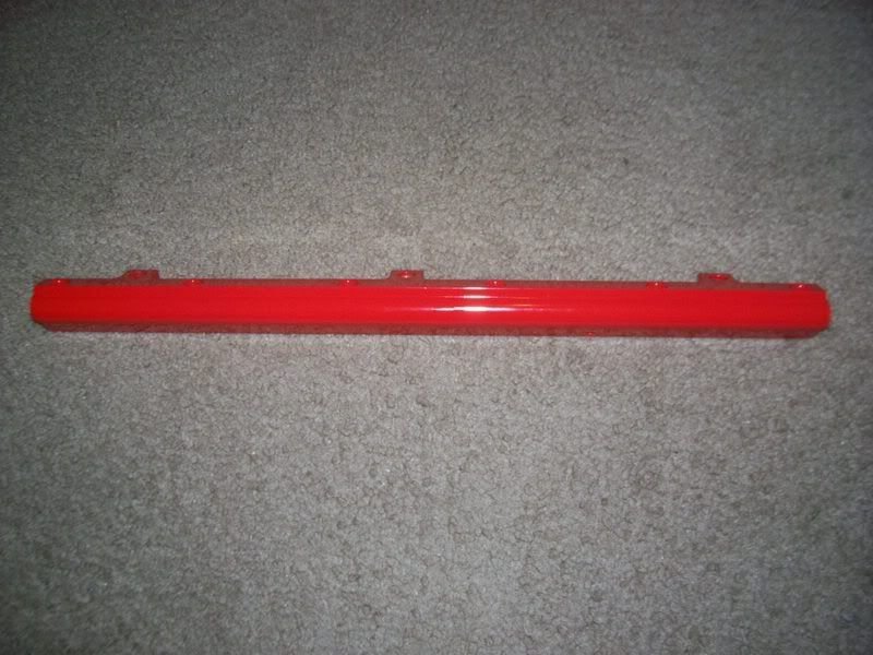

Also my first piece was a red fuel rail, testing everything out

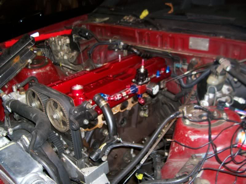

Installed on my old/current engine. I chipped the left one some when i put them in the car...I wasn't thinking and i let it bang around in the box, it was a cold night and i was in a hurry cause of the snow storm.

Using an industrial electric oven. The finish on the chrome depends on how smooth the surface on the metal is. Valve cover surface is rough. I was going to use the clear coat but went with the candy instead.
