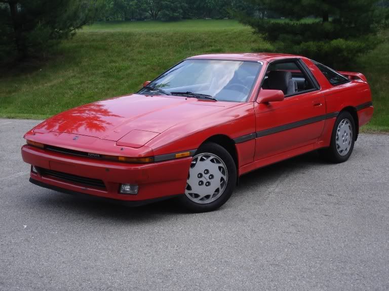

Yup. What all these guys said. Fog lights, front turn signals and front lip are different.
89-92:
86.5-88:
