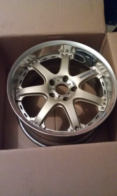

Got ma wheels!! Oh yeah!!!! :D
Pic including obligitory nokia phone for scale. Has more dish than I realised, Im fucking stoked!

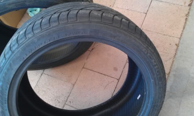

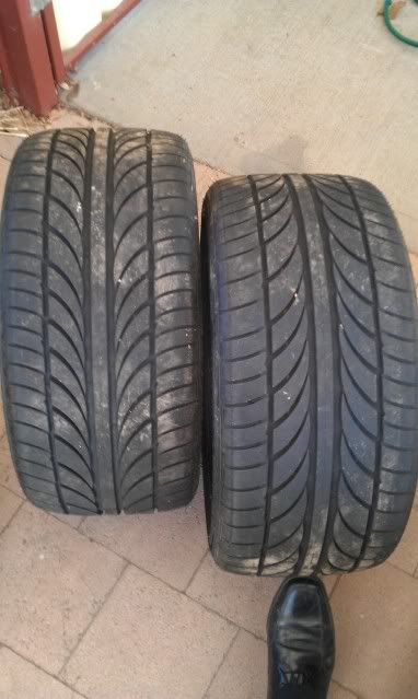

Heres the tyres I picked up for the rear, they were cheap and will be fine to get things moving. Will replace with some RSRs when they wear out.
