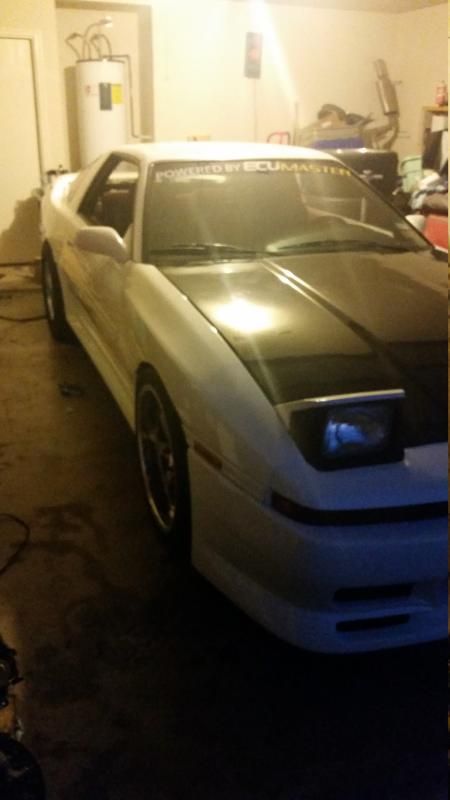

Current pics of the car:
Silver MK3

Nice car, it looks super mean with those big drag tires stuffed under the back. What kind of times were you running with the car?

akito;2024356 said:
Super clean! Is that a hardtop?
Yes
Haven't run it on the new tires, and it hasn't seen a track in quite a while, more of a street bruiser than anything but I'd like to run some times in the near future.

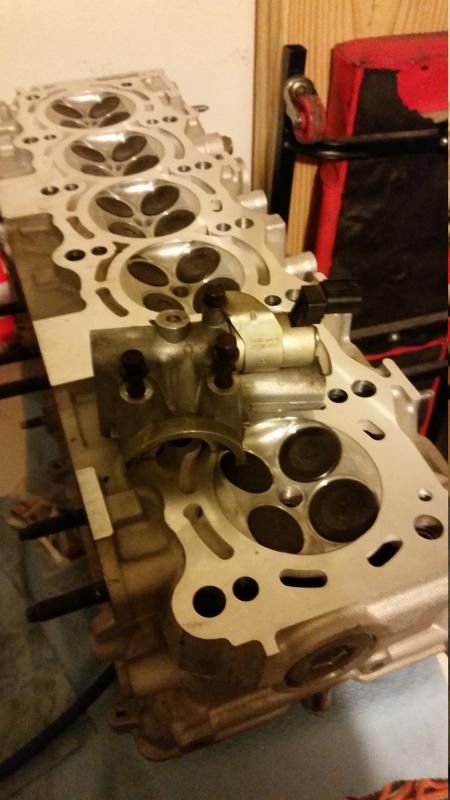

Here's the head, previous owner of it did a valve job and decked it, I may do a little port work but we'll see. It will get springs, retainers and cams.

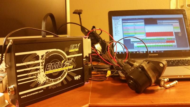

Doing some bench testing of an IACV. You can see the corvette pedal in the background. I won't need the IACV with the DBW throttle, so that will be going away.

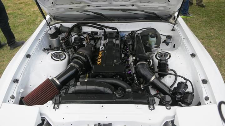

Current engine bay pic:

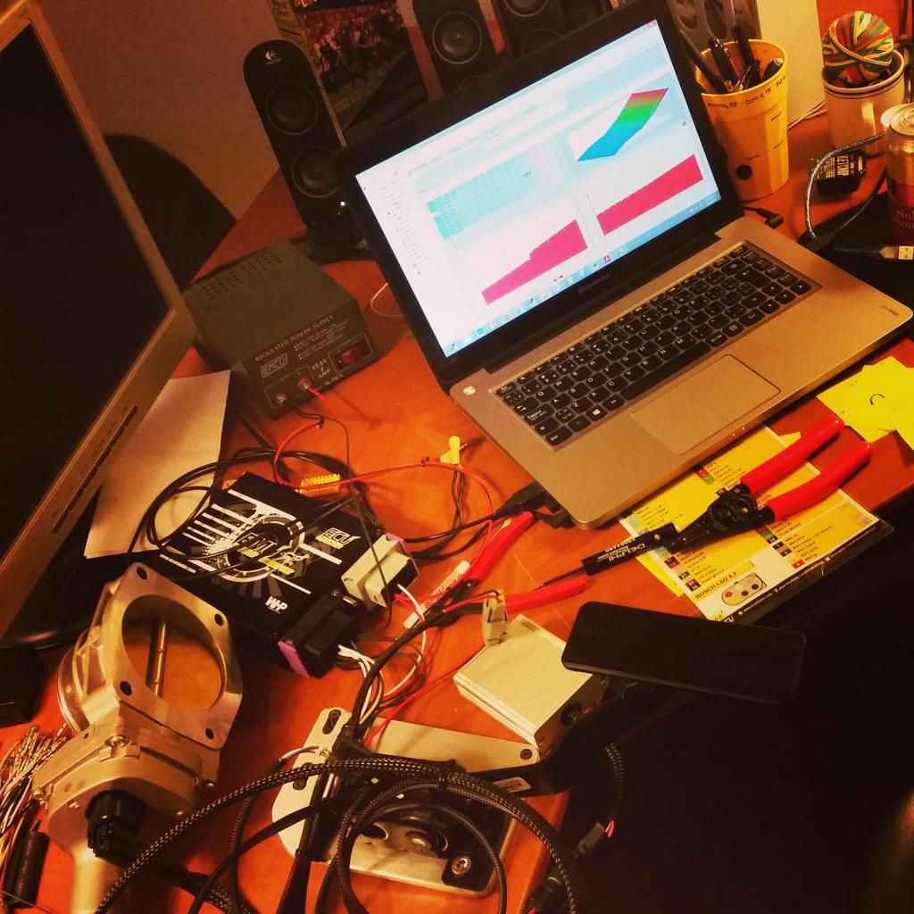

More bench testing, this time with the DBW throttle:

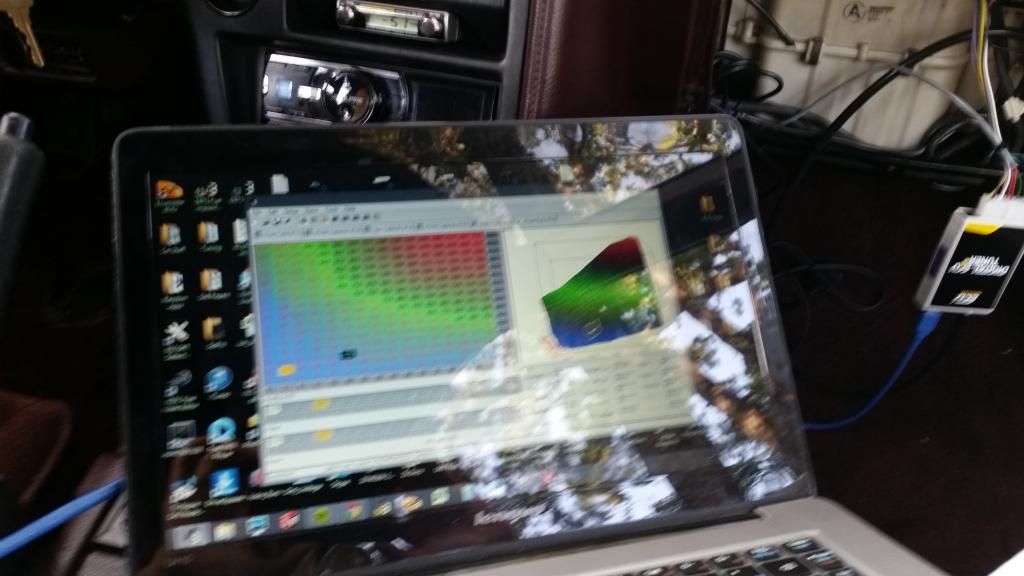

Somewhat unrelated, but tuning one of our piggybacks in a buddy's 2JZ-GE-T Mk3 running on 7M electronics. We deleted the AFM and did some other neat stuff, car runs like a champ after the fact, he'd had constant issues with the AFM.
