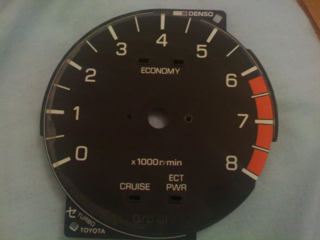

The economy twin lights (green/orange) are on Euro Spec Supras only. It stays Green at idle when you drive easy...
When you flour the 'pedal to the metal' it will go Orange indicating that you are out of the economy range.
It works with a vacuum valve located on the firewall (driver side) near the small clutch reservoir tank,and it
gets a vacuum hose to make the adjustment between green and orange!
---------- Post added at 06:04 PM ---------- Previous post was at 05:51 PM ----------
Here is a Euro Spec Tacho sheet with the 'ECONOMY' mode.....

"It works with a vacuum valve located on the firewall (driver side) near the small clutch reservoir tank" Could you poste a pic of it please?
