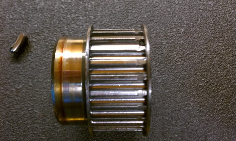

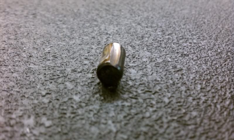

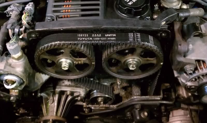

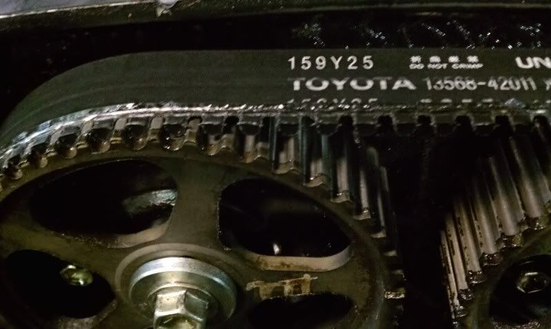

So I opened up the timing cover today to replaced the front crank seal and to my surprise this is what I found, besides a brand new timing belt and very poorly installed front crank seal.
The dowl pin for the tensioner came out, fortunetly it didnt do much damage. Everything behind the timing cover was covered in oil and belt material. The dowl is a whole 64 cents but will take until tuesday to get here.
