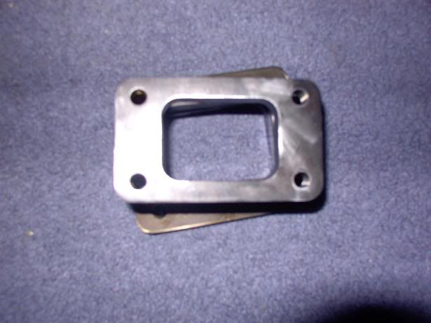

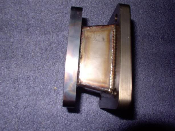

Also, is there anywhere I can buy a ready-made angled T4 spacer like the one in the photo? This one is a T3-T4 adapter, but I need a T4-T4 one to move my turbo up in my engine bay.
John made one for me years back, when I was building a 7M. I sold it a long, long time ago to someone.... Anywho, maybe john can bounce one out to you....

Jon@MDC made one for me about 1 year ago. Never got around to use it. Only mocked up on a T4 manifold. It is for sale.

Think Brad needs T4>T4 Mo.

'Doh. I just read over his post again. Goodluck with the search Brad. In any case, I also have a SS manifold for sale :naughty:
