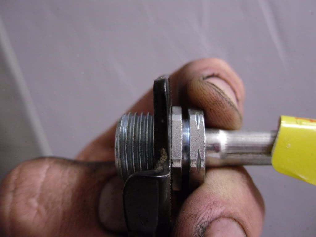

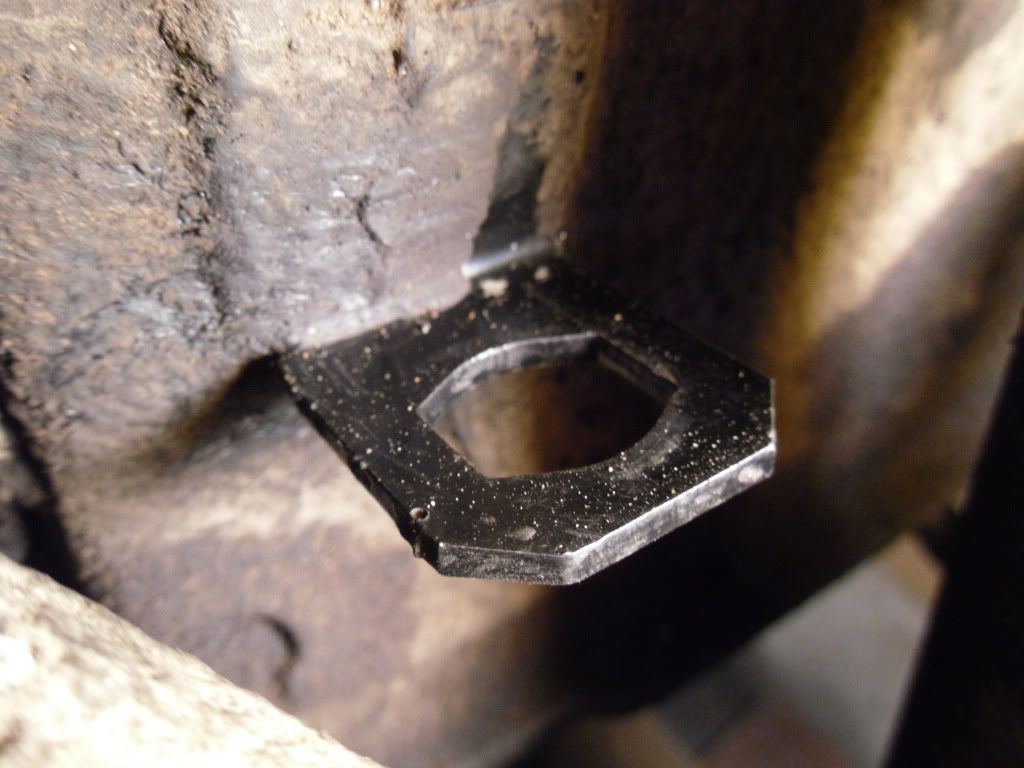

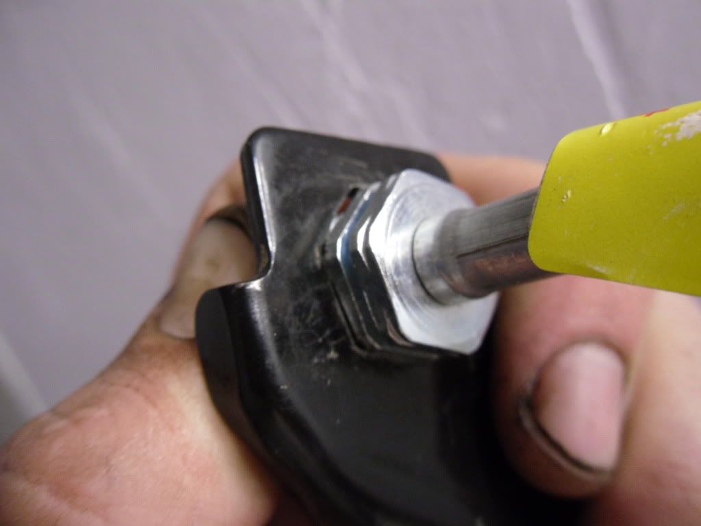

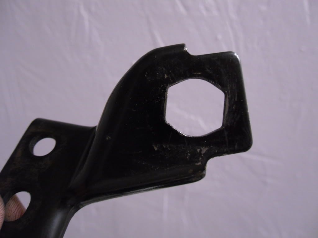

Yeah, they hold them in place. What happened was that the Earl SS lines come in 2 pieces vs 3 like stock. So, you have to pull the longer line through the lowest bracket and fit it into the middle bracket in order to hold it in place. Both of those brackets looked like they were shaped to fit, but they didn't.
Thanks to my handy Dremel, problem solved.

here's pics for what I was talking about...
