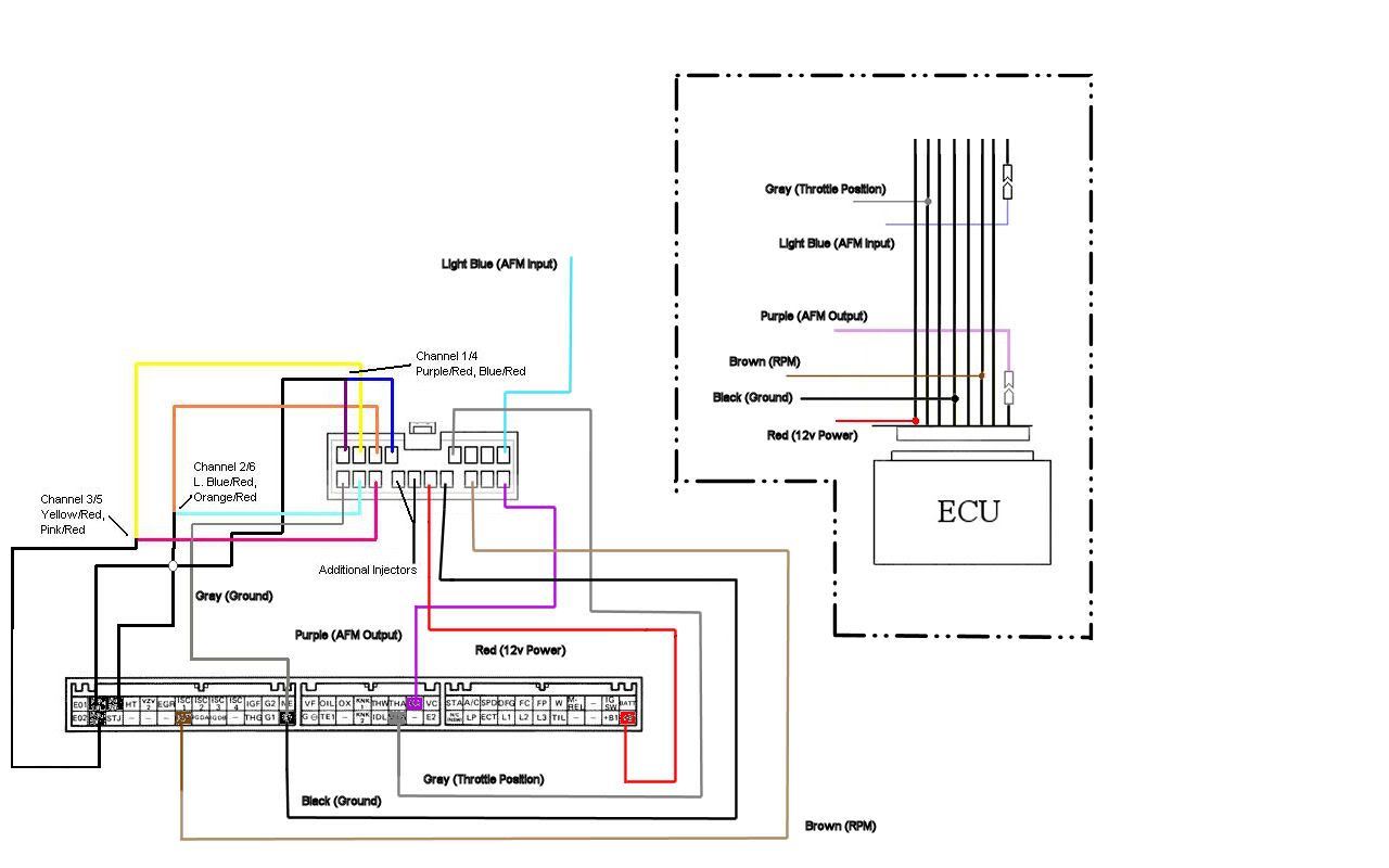

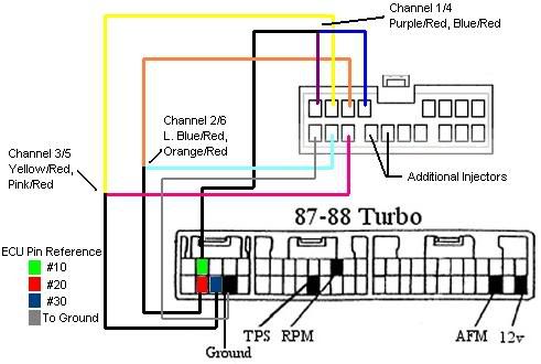

Ok, so I got an emanage blue with the injector harness.
Question1, how the hell do I hook up the injector harness? Greddy's instructions suck. It looks like thier copy machine was out of toner on my manual.
