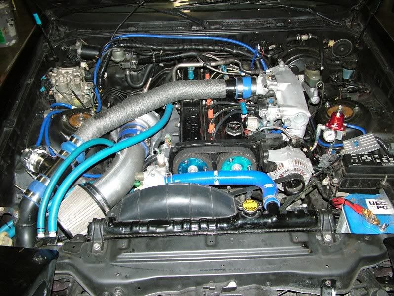

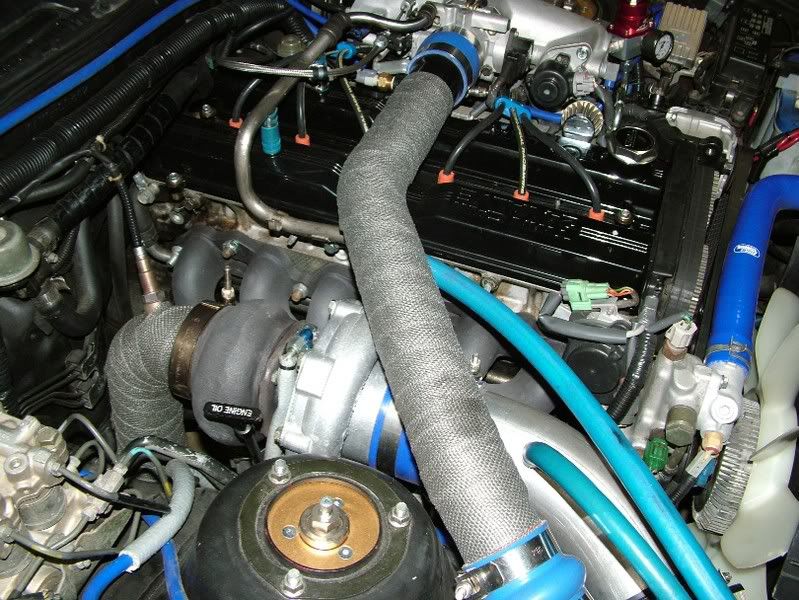

Here's the latest pics, still a few things to finish up before the Vegas meet.

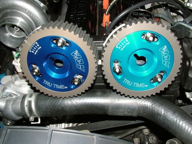

IJ. said:
Your Cam pullies don't match ;)
Many thanks to AEM for shitty quality control! :biglaugh:
I will not be buying any more AEM products, their customer service is teh shitz.
Here was the ones I originally got, the two on there now are better but still not the same.
Keep in mind they only have one part number for blue, and all the boxes are sealed so you can't see!!! :icon_evil
They also put a silver bolt in one box, and a black bolt in the other :icon_evil
They would not exchange them for me at AEM, I had to take them back where I got them (I'm a reseler btw) to return them and wait for another set. I said screw it, give me one that is close. We opened up silver cam gears too and one was a flat finish and one was shiny!!!

I'd just take them apart and re-anodize them for $25. Long as it wasn't black you could still see the degree markings and such fairly eaisily.
but that's beside the point, AEM should have taken care of you on that one...
True, but why spend $25 to fix $300 in brand new parts? I don't think you'll ever see two HKS cam gears in different shades of purple. :icon_wink
by all means you shouldn't have to, I just think it would be eaisier to have them reanodized then deal with crappy CS reps...plus then you can have them pink if you really wanted to :naughty:

Hey Aaron, you can just tell people that you use the colors to remind yourself which one is the intake and which one is the exhaust...:)

JMDigital said:
wow. I wish I could get my engine that clean.. ! How the hell do you do that. Is it even possible without removing the engine?
Thanks! Glass bead cabinet FTW! You will have to take it apart to do it though. I even disassembled the alternator and removed the windings from the case to bead blast the aluminum.
