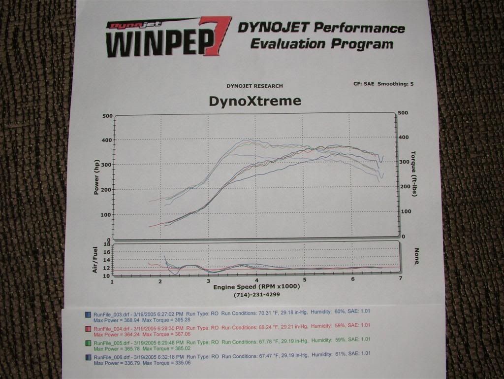

Here was my 50 trim:
Highest number was at 20psi, lowest was at 14psi. Had a exhaust leak at the manifold :(
550's, maft was draw through, elbow and exhaust, forged pistons, spearco style ic, pump gas.
You really don't have to go 60-1 or bigger to make good power, the torque was almost 400ft/lbs at 3700rpm.

that was tuned or un tuned? the reason i ask, is because i want to run a 57 trim at 10 pounds and am wondering if it would be safe like that. my fuel system should be good, 550s/lexAFM, walbro fuel pump and aeromotive FPR.

We were tuning it on the dyno with the afc, which is why the numbers were going up with each pull. I never realized the full potential of that setup because there was an exhaust leak and there was a stock flange bolted to the 3" high flow elbow and welded to the 3" exhaust like a restrictor plate :( That dyno sheet was March of 05. I'm pretty sure my hp numbers are higher now. The 50 trim seemed to be a good comprimise between quick spool, torque and hp output. The 57 trim would probably be able to make more power but give you better reliability then the 60-1 or 62-1. That 50 trim was still working great after two years at the power level on my dyno sheet.

i was thinking a 50 trim would be a waste of time, but that dyno sheet looks nice and around the power output i am looking for. probably will still go with the 57 to try to get closer to 350-400 hp while still keeping the boost low.

Also, it would seems that a 50trim would cause an efficiency fall off after 20psi
Yes, and? :biglaugh:
If you want to run more then 20psi you probably should not be running a ct26 anyways. Making the cold side bigger does not take away the restriction from the hot side that is the turbo itself. Get a bigger turbo and make the same power at 14psi as the ct26 does at 20+psi, and then you eliminate some of the inherent problems that come with running so much boost.

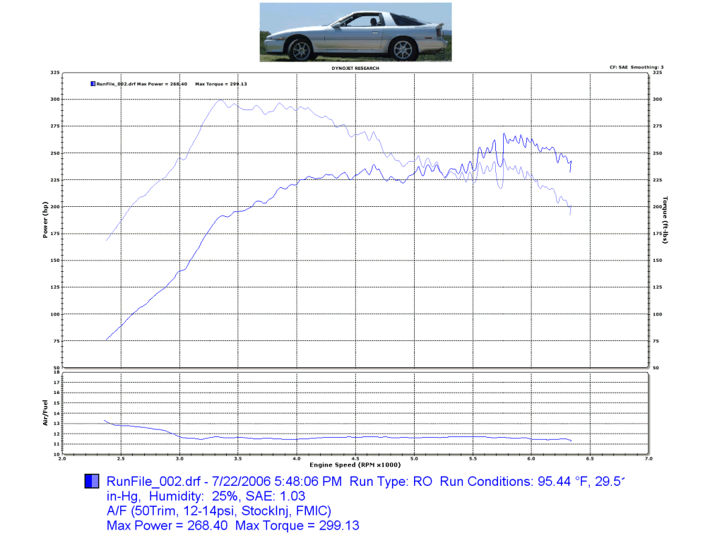

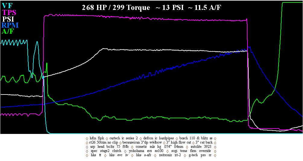

bigaaron - I'm really glad to see your results with the 50trim upgrade. That is exactly the mark I am shooting for.
268 HP / 299 Torque
After the dyno I found out I have a bad igniter, threw a code 14 :(. I think that is what caused the jaggedness.
