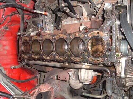

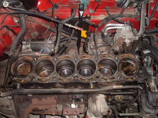

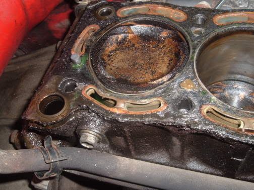

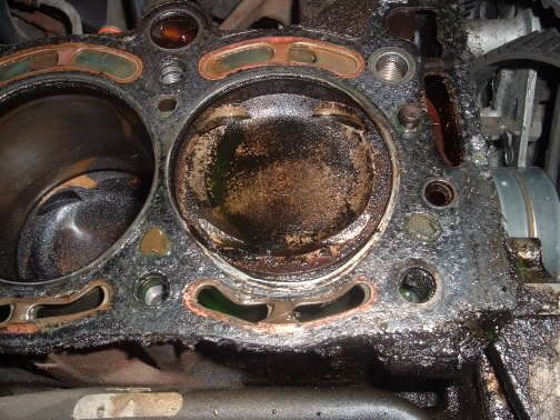

Yep, went out on #1 and #6, both on the exhaust side. #1 was full of coolant but I soaked it up right away.
Just thought i'd throw it out here.

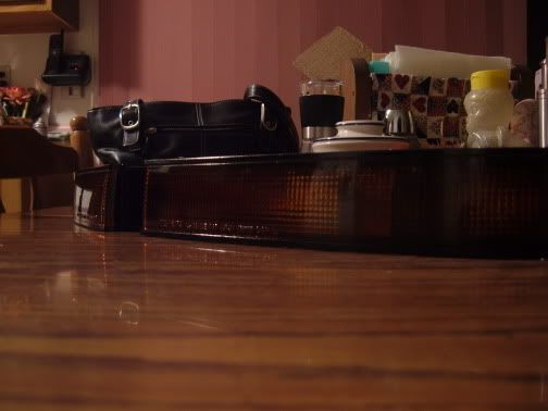

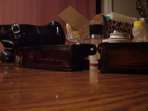

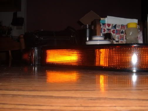

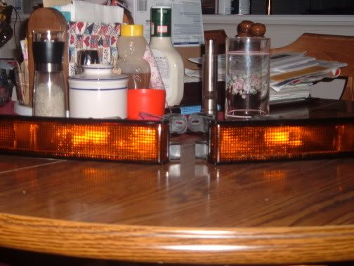

I tinted my front corner markers earlier this week. Just have to clear coat them.
With Flash:
Without flash:
Would go darker but any more and it would contrast too much.

Good luck with the head gasket are you going MHG? And those signals!!!! my word, i love them! Please tell us how you did that.

LouKY said:
To the untrained eye didn't it go on #2 on the exhaust side, too?
:aigo:
Yeah forgot to say that, kinda rushed to post and then described the pics. It was actually goin out on #2 and #5, same spot but not as bad.
As for the turn signals, I just preped 'em, wet sand fine grit let dry, tack cloth, then applied some of this:
http://img204.imageshack.us/img204/1525/dscf2136qz3.jpg
Its made for models thats why it's called 'window tint'.
Still gotta clear coat 'em, hopefully that works well.
