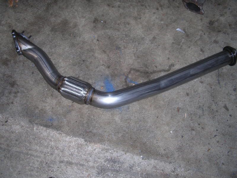

jonny87turbo;1048446 said:
john93t, I looked at titan motorsports website. Do all of there down pipes come with a flex section or does it have to be added on?
This is how it came, i got this one through Rich at summit,
