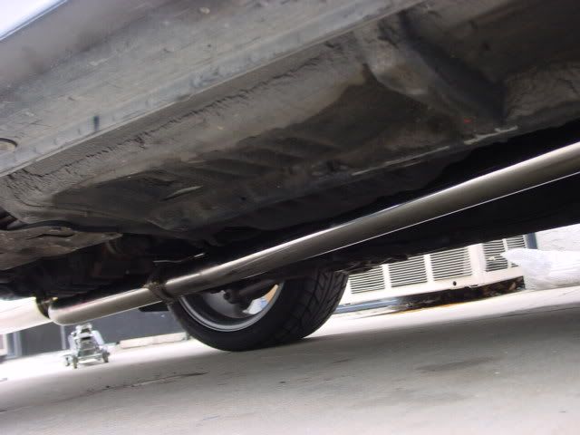

You would spend about $125-150 on the stainless bends, but then you would have to cut them in pieces, tack cut tack cut, etc. In the end you are left with a bunch of welds.
By getting the mandrel bent tubing kit, you are only welding the flanges on and making 1 or 2 cuts. The end result is less of your time wasted and a cleaner look. It's certainly worth the extra few bucks, especially if you want to replace the cat since the DIY piping will replace the cat.
Here is the DIY kit that I installed for my car, and look at the lack of welds. It really will set you apart:
