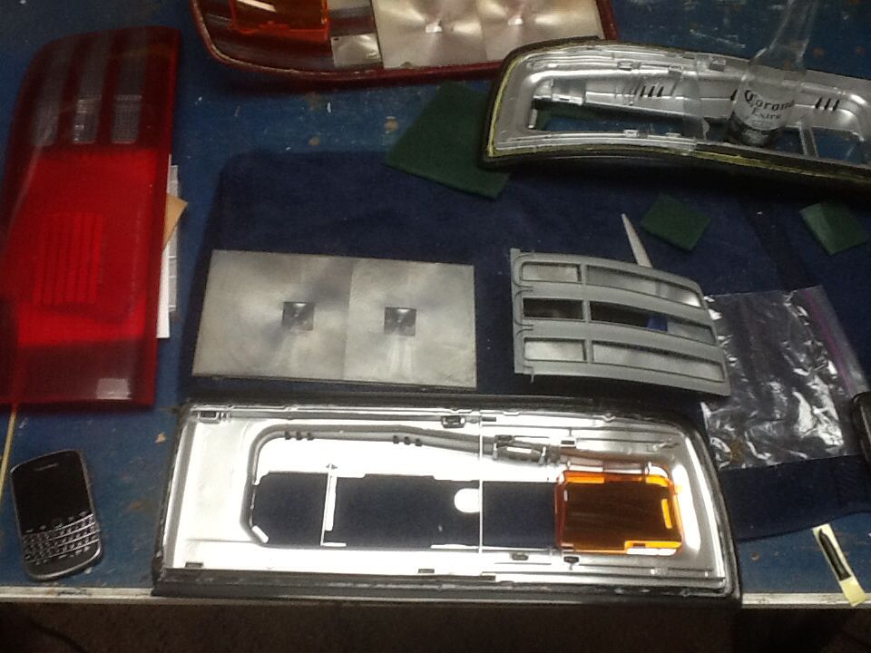

Basically what he is saying is, do this:
Those are my tail lights as of right now and it's a real PITA job. Getting all the original glue out takes hours, I started rushing and broke one of the lenses inside so I bought another tail light and started over.
It will be worth it in the end because I couldn't stand the crap sitting in there.
Edit: Instead of using an oven (because you wife/girlfriend/mother will kill you if you try) I filled a sink with HOT water and submerged the tail lights, it softened the glue and with a bit of effort the two halves separated.

This thread is what lead me to refinish my lights. No clue how you got ALL the glue out, you've got more patience then I.
It was a long while ago, but I am pretty sure it got softened by the hot water, then the rest just came off nice and easy. I remember it wasn't an overly hard project. it was one of those projects that are just fun to do on the side. only took a couple evenings if i remember right.
Sep 19, 2011
510
Des Moines, IA
lol okay, reading through that old thread I remember where I scrapped the glue out from. Yes, it was time consuming, and a bitch to do, but wasn't really hard at all, and if you don't have anything else going on its a pretty fun project actually.
