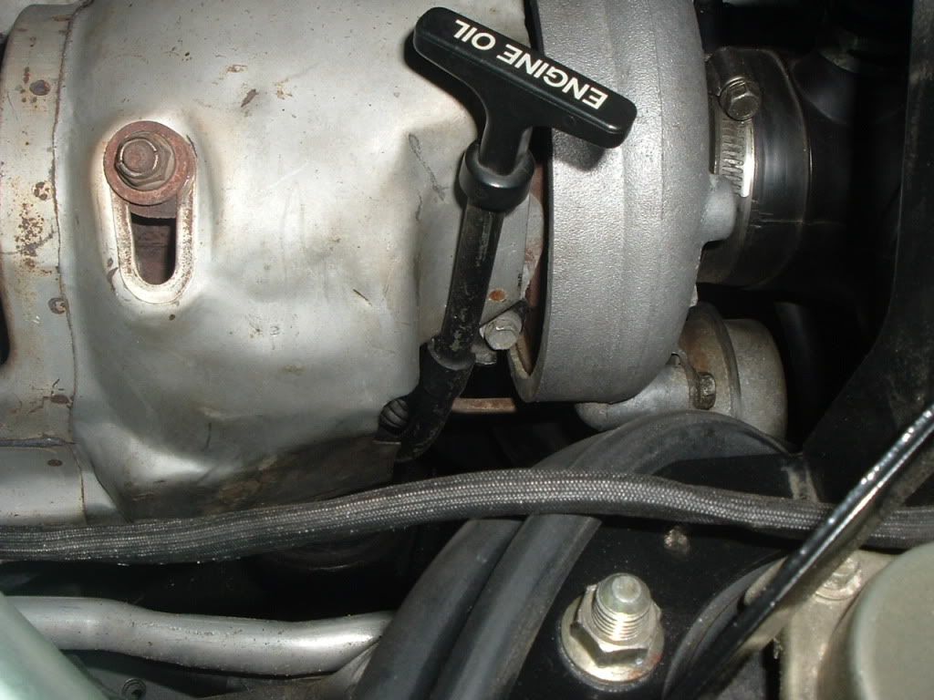

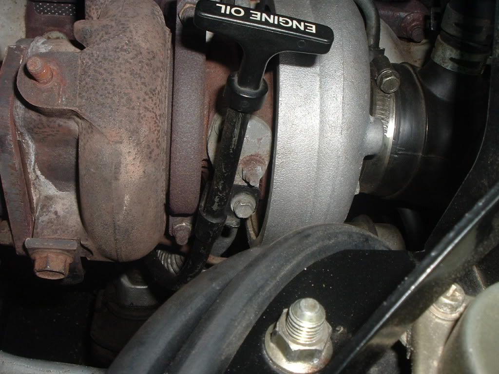

Pics are worth a million words and a green thumb ;)
Look at the pics. it is pretty self explanatory. It bolts to the turbo.
On to pics

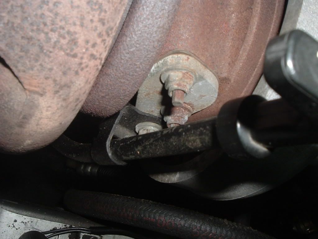

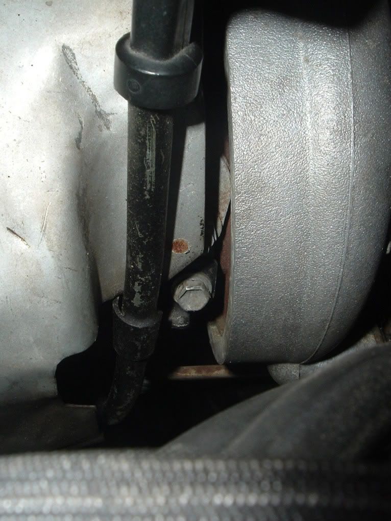

Here is a close up of where it bolts up and the bolt it self
If you really need I can remove the heat sheild on the turbo to get a better pic. Just let me know

If it isn't too much trouble that would be great, I think I know where it bolts, but I want it right, I've spent too much on this thing to get something simple wrong.
92nsx
Sep 30, 2005
2,957
Clearwater, MN
No prob again. Im just farting around in the garage today, so since I was out there it wasn't a big deal. Happy to help.
