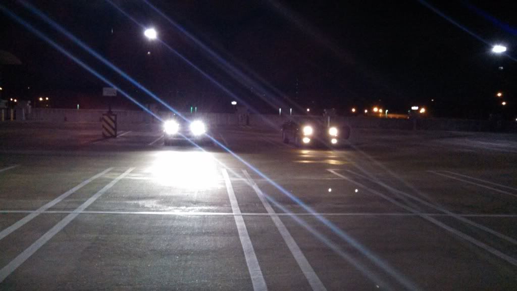

Yes, there is a solenoid in the projector that will pull the shield down to give you high beams. $40 for a pair of projectors is awfully cheap. I would be worried about sub-par parts at that cost. These are my 4300k bulbs in my Mini H1 projectors.
This is below the cutoff line.
And this is the cutoff line.
So you will get a blue effect as you pass through the cutoff line.
