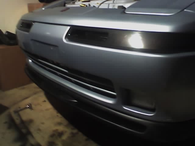

Like the top one?
and the ones in my sig....

http://7mpwr.com/pictures.7mp?i=DSC00547.JPG
http://7mpwr.com/pictures.7mp?i=DSC00688.JPG
http://7mpwr.com/pictures.7mp?i=DSC00689.JPG
http://7mpwr.com/pictures.7mp?i=DSC00545.JPG
http://7mpwr.com/pictures.7mp?i=DSC00548.JPG
http://7mpwr.com/pictures.7mp?i=DSC00549.JPG
like those. Goto any hobby store get some testors Model Tint spray, comes in little 3oz cans. Need 3 of them, Goto autozone get some duplicolor clear engine enamel. The stock lights theres no need to sand just prep w/ soapy water make sure to rinsse and dry compltely. Spray tint on in even coats allowing to fully dry between each coat to achieve true darkness. Continue to apply until darkness achieved. Go over each piece with the clear enamel spray paint until shiny and smooth. Wet sand and spray clear again until smooth.
Let it fully dry for a few hrs and install, step back take pictures and watch as the tint never fades from washing dirt etc.
edit:
My front lights are fully blacked out (Light still shines through) side markers are tinted to almost black, rear tail lights are a dark blood redish almost black color. Did all my lights minus the headlights and fog's. The pictures your seeing are pre clear coat enamel, i havent taken any with the clear coat on them their a shitload shinier. Ill snap some pics once the supra comes back from paint.

yessss. i have always loved the pre 89 style bumper, but ever since those signal covers were copied ive been planning to swap over to the 89 style just to rock those covers!

nice thread... not sure why i didn't think of blacking out the supra lights... i just got through tinting the turn signals on my daily driver Focus ZX5 with some very good VHT NiteShade tint paint.
I love that pic ND, what percent tint is that, 20? It's so dark. I usually don't like the chrome wheel look but you make it look great
