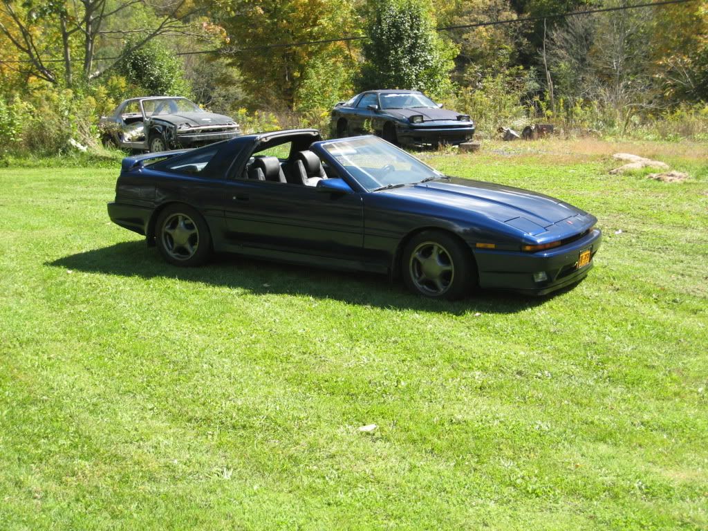

Hey, I've been meaning to put together a new build thread for a long long time, I figure now that the summer is winding down and my build is basically going from semi-complete to starting over I might as well start a thread...
Here's the long-winded, rambling, and boring backstory, I bought my first Supra, an '88 Turbo automatic, back in '97 when I was 19 years old. Drove that car through college with only minimal mods, mechanical boost controller, Intrax springs & ST sway bars, gutted cats on stock exhaust, intake... beat the crap out of it for 6 years then finished college and parked it to be a "future project" and drove my 'more adult' Grand Am. [/COLOR]
In 2007 I traded a laptop for an 87 turbo targa with "solid body/engine, already primed and ready for paint!!" so that I could Frankenstein it with my old Supra into the Supra I'd always wanted. My goals were simple, a good looking targa top ~400HP cruiser.
I started devouring every book, video, website that I could find on bodywork, engine work, suspension work, basically everything, I was jumping in as a computer guy with very little automotive knowledge. (I'm lucky tho - my dad is a Toyota MDT - 30+yrs with Toyota, super useful guy :) )
Well I spent the next couple of months stripping both of the cars down and the further I progressed into the targa car the more rust I found - and as I sanded off the primer i found more and more bondo - nice and smooth and well hidden and all but still, hardly any metal in the rear of the car... disheartened I gave up and the car sat, stripped almost to it's frame, in my dad's garage for a couple of years.[/COLOR]
In late 2010 I again caught the Supra bug (not that it ever really went away) and bought an '88 Turbo M/T car that was in semi-ok shape - pretty much everything that it needed I'd already had from my 2 parts cars but it definitely needed a paint job so I would have to learn how to paint a car in a garage.
While doing a semi-rebuild getting everything straightened out mechanically last summer (Lex550 mod etc..) I totaled my daily driver and had to slap the Supra together so I'd have something to drive for the few weeks I spent looking for a daily driver. (still had the prev owner's crappy paint job and multi-colored body panels and missing 50% of the mouldings - how embarrassing!) (off-topic: I found a mint condition '99 Grand Prix GTP that I couldn't pass up for $3K and that's still my daily driver today, it's cool comparing the supercharged stuff in that car to the turbo system in the Supra but I digress) [/COLOR]
Last October I finally got around to repainting the Supra - way more work and way more hours and way more nickle & dime stuff than I ever could have imagined and after all that I had screwed it up enough that I need to repaint it again - tho this time I've learned so much (especially about why you don't use the cheapest clear coat you can buy) that I think it'll be much easier/better/cheaper/fun this time around.[/COLOR]

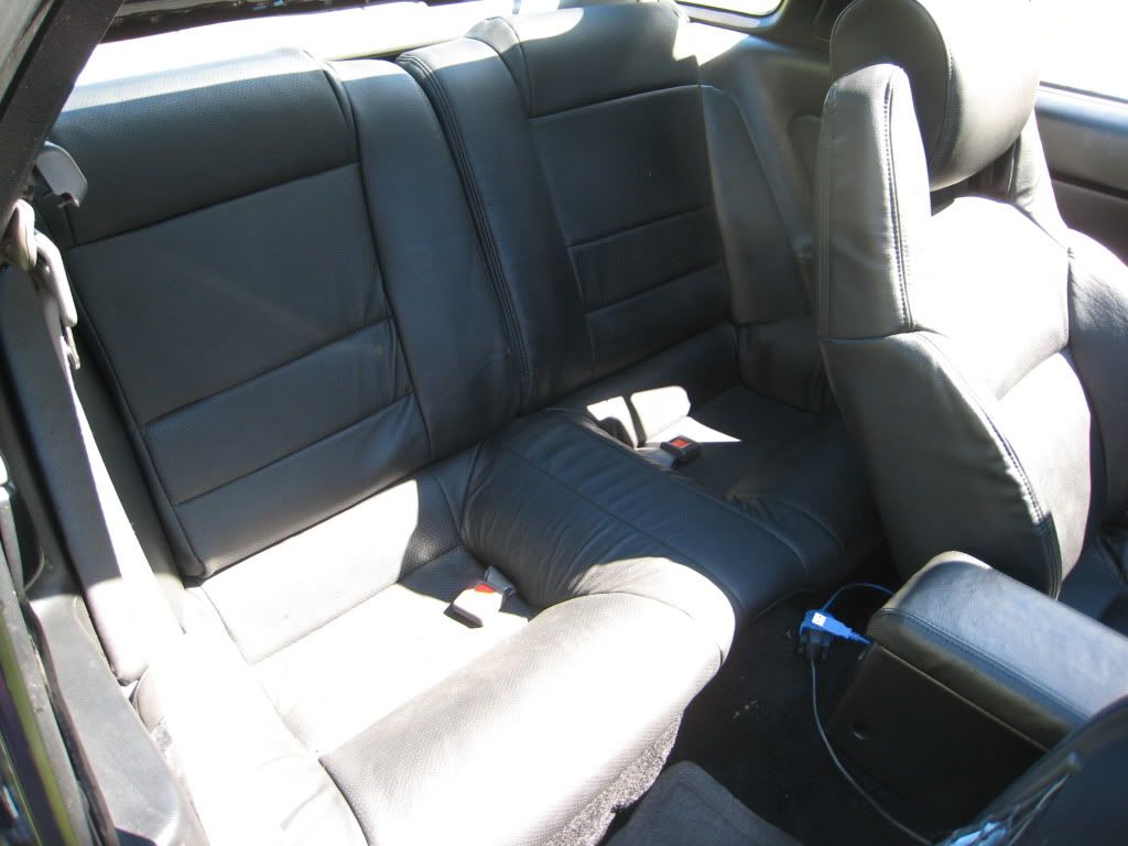

Oh, I almost forgot, over the winter I re-covered all of the seats with black leather, installed a new black carpet, and dyed all the rest of the interior black, so I went from a hodgepodge of maroon, grey, and blue interior to all black.Oh, another thing I almost forgot from this winter, completely rebuilt R154 and installed SPEC Stage 2 clutch...

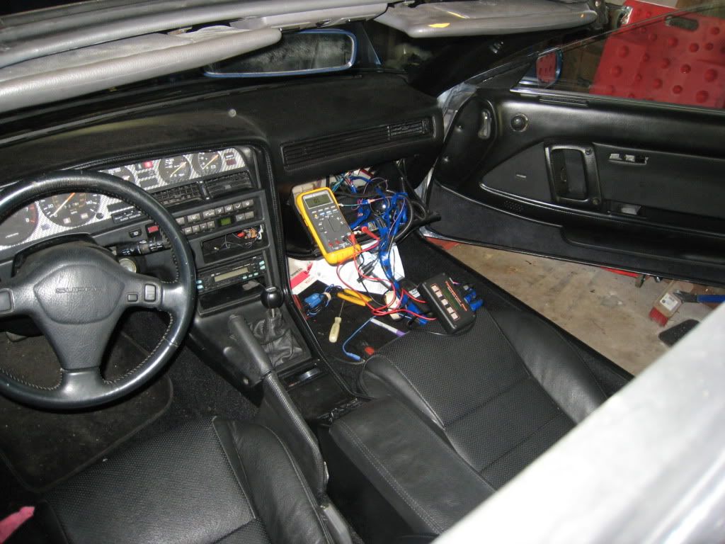

Anyway, that brings us up to this summer. I've recently abandoned the Lexus AFM + SAFC route for a Maft Pro. I've been working on wrapping my head around that whole system and trying not to destroy anything. And - from just "slapping" stuff back together last year in a rush I've ended up with a ton of stuff to deal with, mostly every seal and gasket in the engine is leaking - now I have a feeling that this restart is necessary and will end up being way less stress than my last try - I'm way past the steep learning curve that slowed me down last time

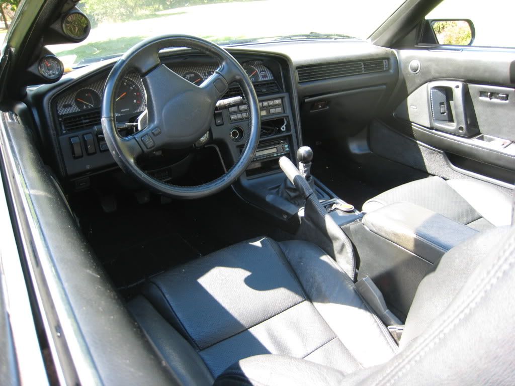

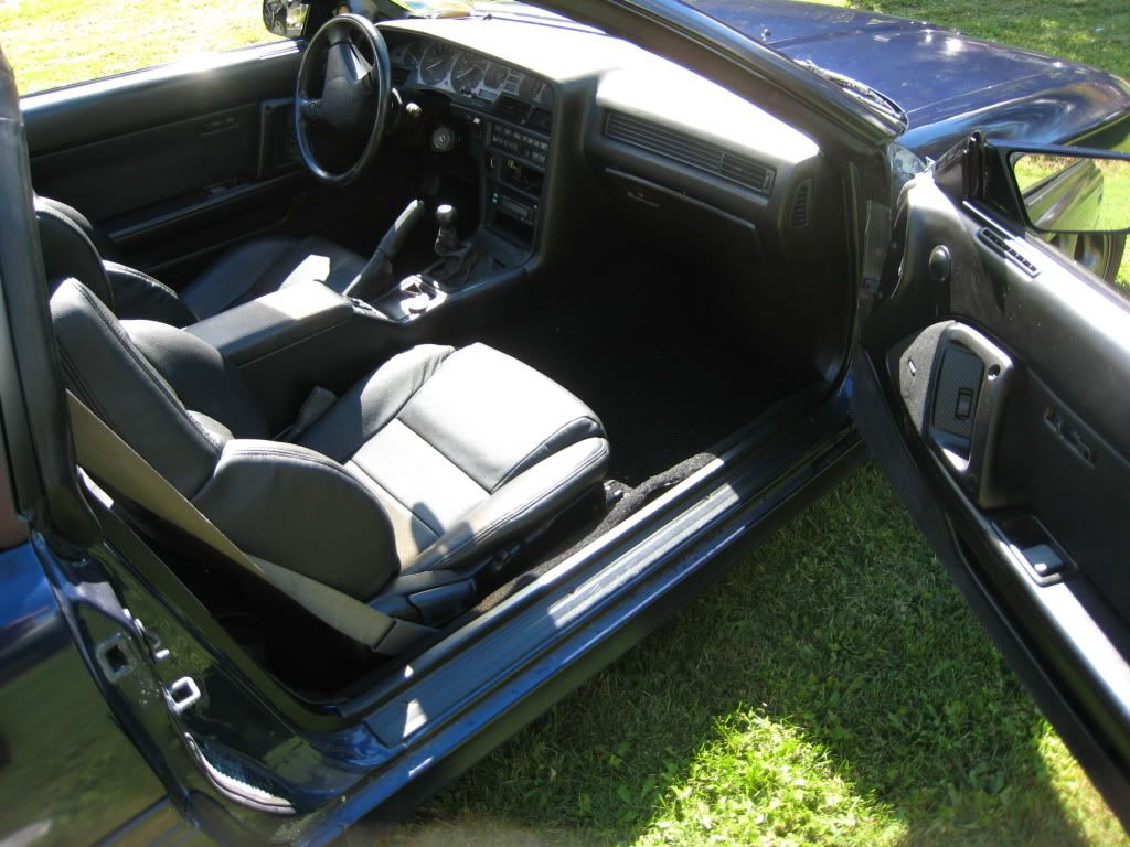

So yesterday I washed the Supra, took a few pictures... I finally got some shots of the interior (still bits and pieces missing)
I also set up the enhanced TPS stuff on the Maft Pro - it did fix the lean spot I was getting when entering boost - the Enhanced TPS functionality has really made tuning more enjoyable.
I've been to the fullthrottletech site and yes, there's a lot of info there but it's the most disorganized mess with threads that just end without solutions... My biggest issue was that the ETPS and Timing Monitor/control stuff requires searching the forums, digging through threads with contradictory information and then still pretty much making it up on the fly... Don't get me wrong, it's all fun, but when I decided on the Maft Pro I'd seen all the stuff available online and it wasn't until I was really diving in that I realized how most of the information is scattered at best.

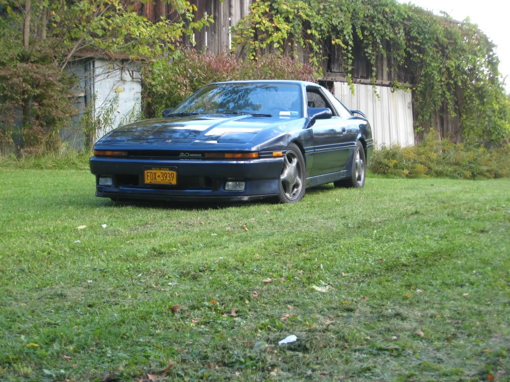

In front of its siblings that had to die to give my Supra life
Vroom! Tanabe Touring Hyper Medallion!

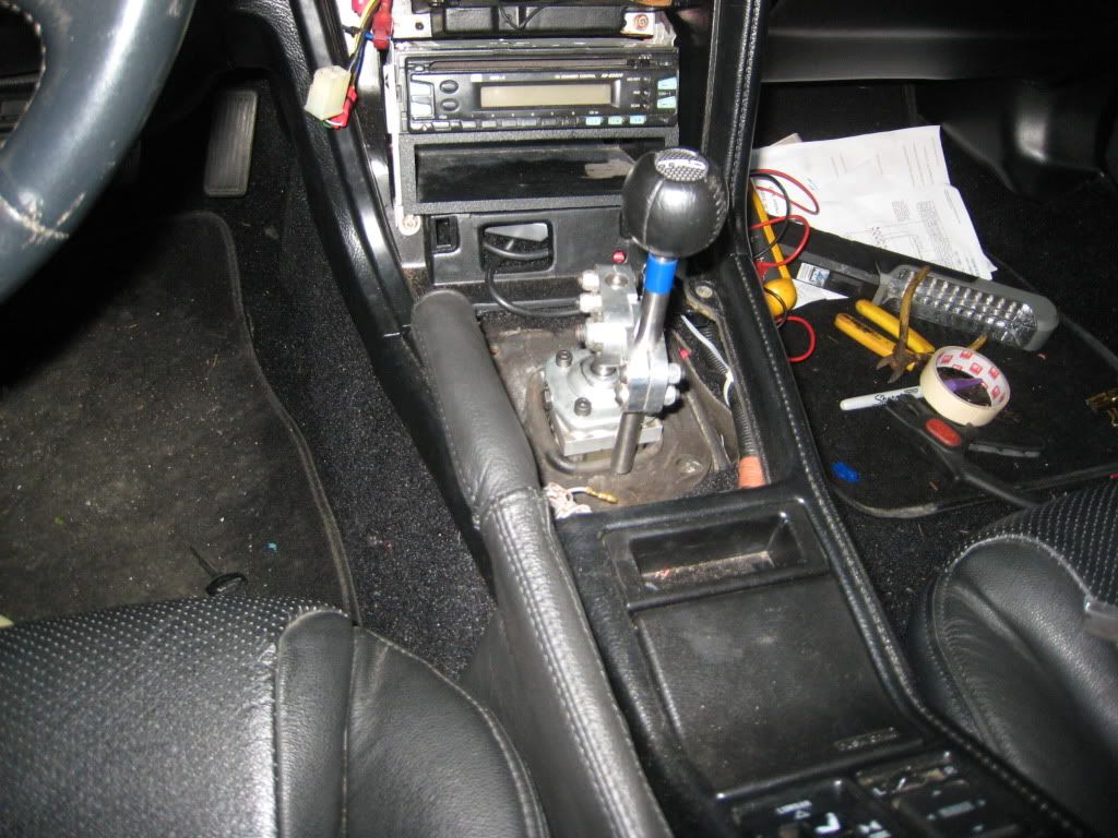

Nashman v2 short shifter:

Interior... still need to make the seatbelts and visors black...

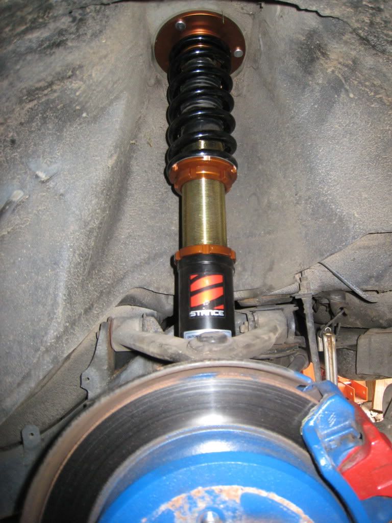

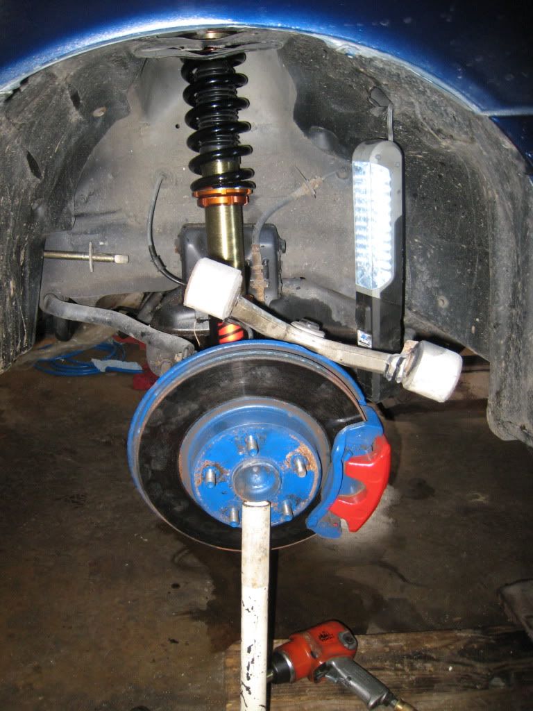

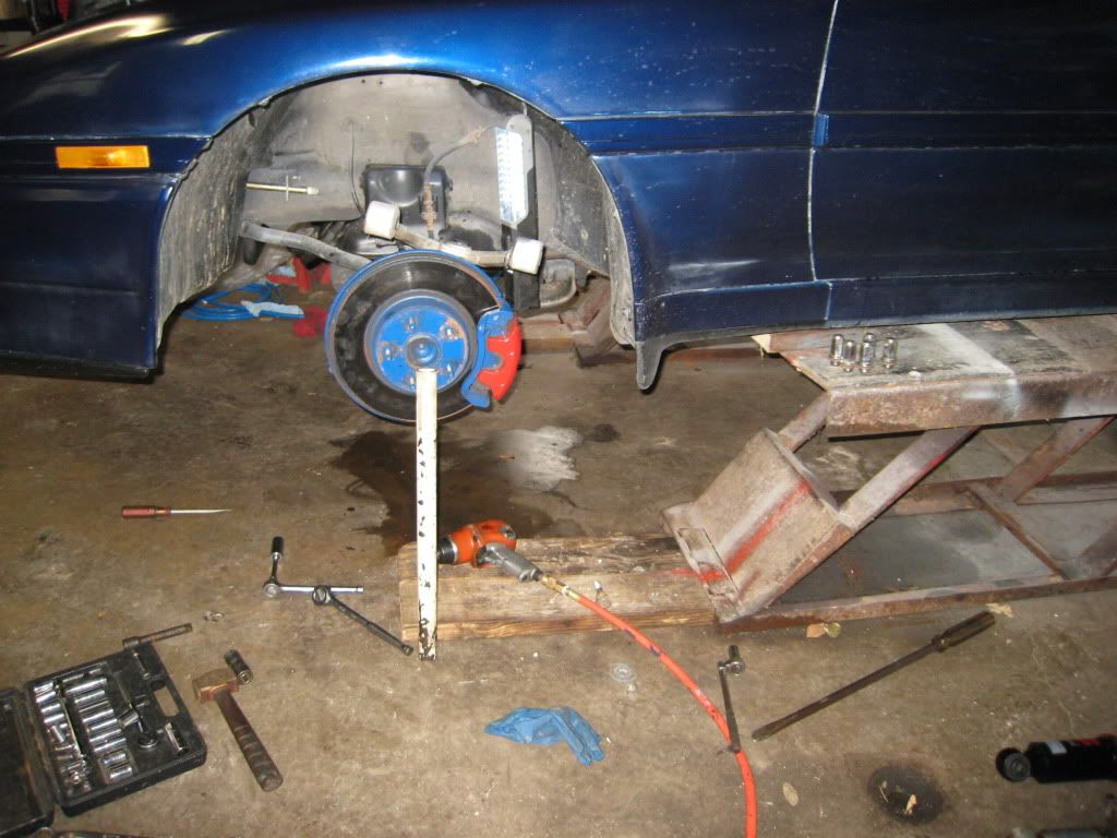

Well I got the Stance coilovers installed over the weekend, So far I'm pleased, I don't have much to compare it to but the coils are definitely better than the saggy Intrax springs they replaced and the 4 blown shocks. The ride is firm and, I'm not sure what words to use, but it feels 'stuck' to the ground whereas with the old setup it was super firm (felt like kidney punches on a bumpy road) it never felt very well connected to the road.
Words suck - here's some pictures...

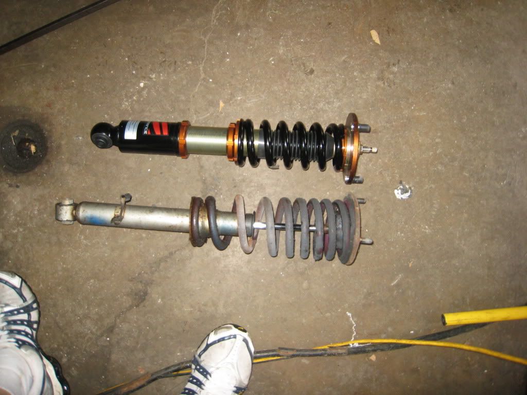

Old setup vs new
Makin a mess

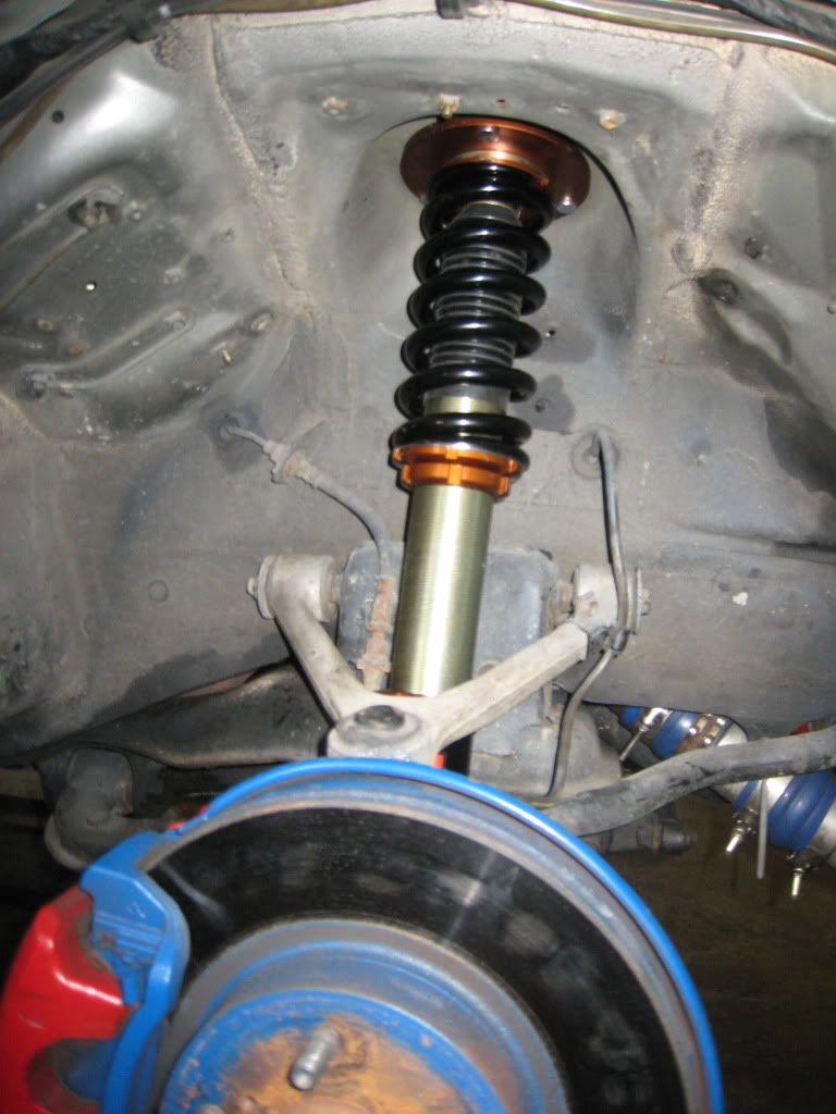

Front installed (Tried to set it to stock height)
Rear Installed

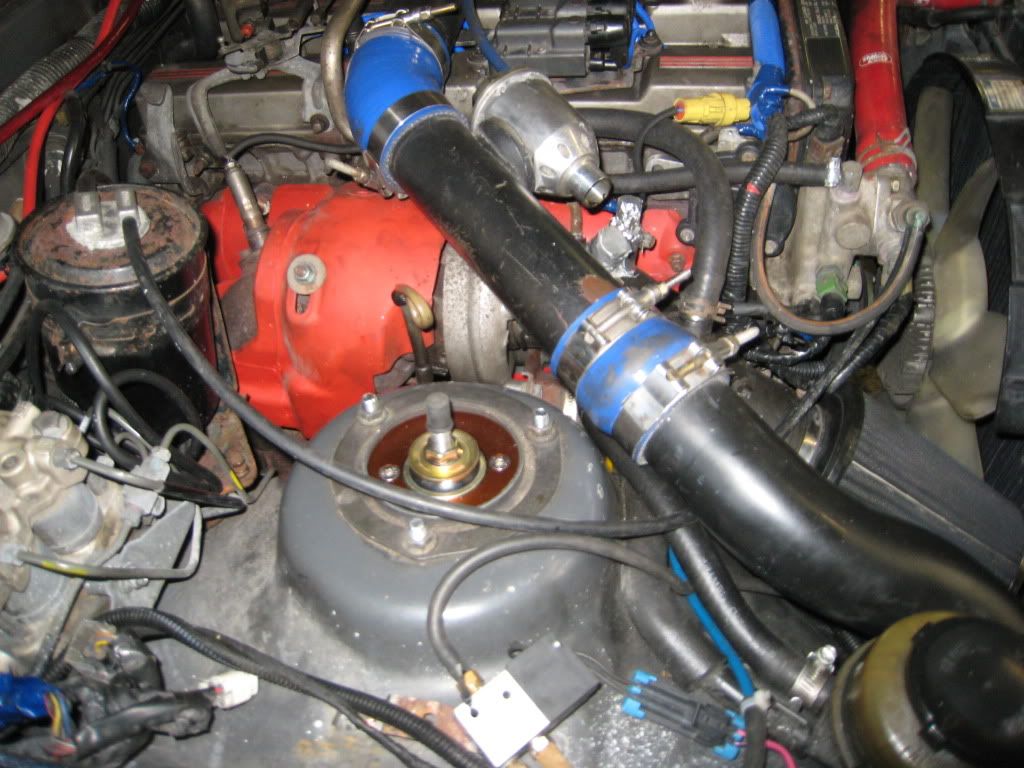

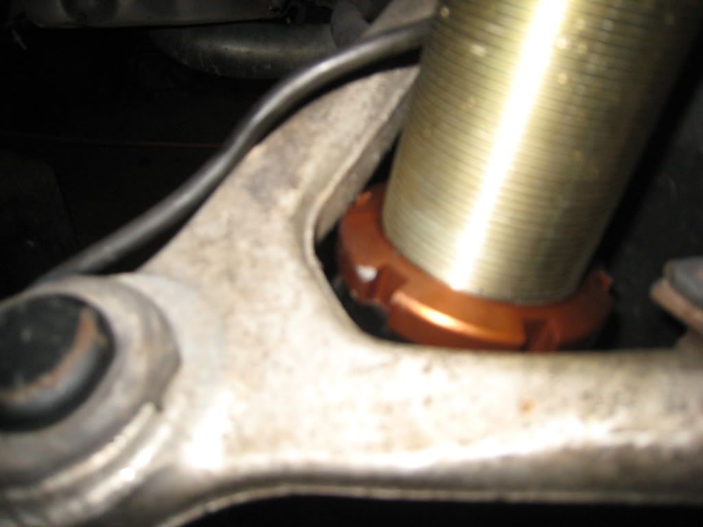

Here's the problem mentioned in another thread, the front coilover's locking nut is right behind the suspension arm. The only way I could access it was to undo the suspension arm and move it out of the way.
Top view of shocks (Don't mind my ugly engine bay - everything is in a state of "just make sure it works" since I'll be pulling/refreshing the motor and painting the engine bay starting this weekend)

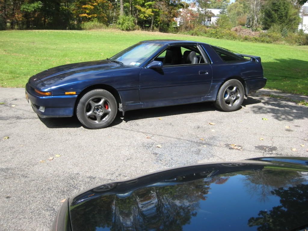

Hahaha! 4x4 baby! It's been so long since I've seen a Supra sit this high!
Dropped it... it's set a bit higher than it was on the Intrax springs, much easier to get in and out of :) and I haven't bottomed out yet (it was a constant struggle before w/ the old springs and 3" exhaust)
