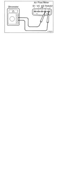

i can't seem to get rid of this code. i'm running the maftpro and i have the 2.2k resistor inserted into the old MAF plug. am i doing something wrong??

Make sure the resistor is between THA and E2. Also you may have to reset the ECU for the code to disappear

here:
