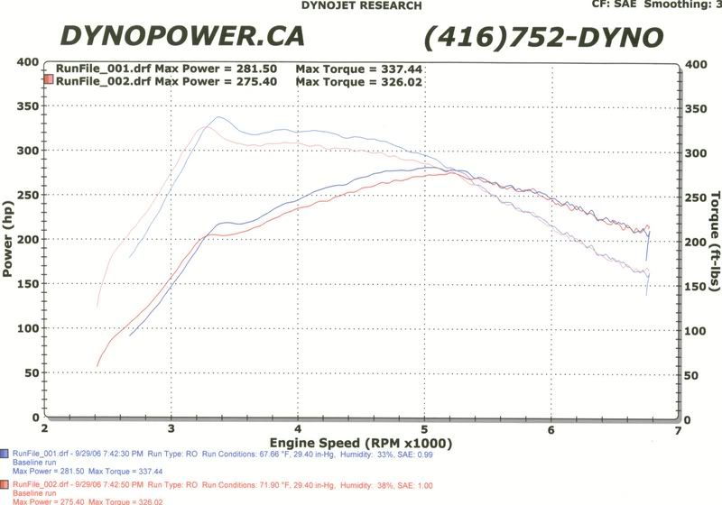

I had planned to aim for an AR in the low 0.6X but this Jr. seems to fit the bill. I am concerned that the Jr. will have the same issues with flow in the upper RPM range. I'm sick of having a dyno graph that looks like a mountain range. lol

I don't want as much fall in the graph through the RPM range. I want it to rise quickly and flatten out. I want a broad power band that is very usable on the track. I plan to track this car on big tracks like Mosport as well as the Auto-X.
