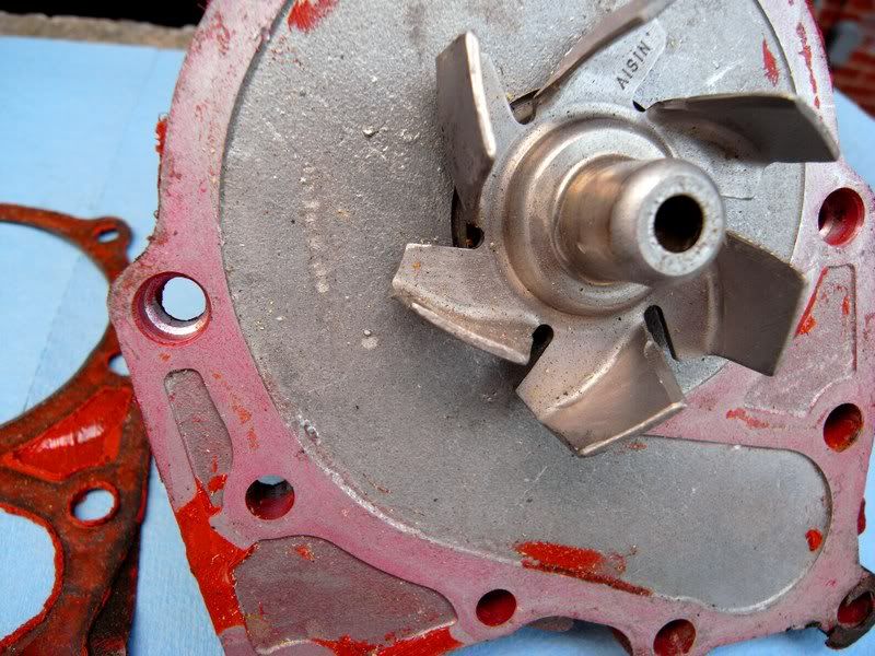

^^^ Pretty sure this one was fairly fresh... but the car sat for over 5 years... so I decided not to mess around.
^^^ I am in the "camp" of those who prefer/insist on the AISIN oem pump... which has (in my experience) the STAMPED impeller, instead of the LUMP CASTING of questionable dimensional precision. Could it affect FLOW? No sense taking the chance. (PLUS, I've had a cheap reman. pump with GRIT for a bearing on my MKII job well over a decade and a half ago.)
^^^ Necessary or not, I took a small file to the LITTLE BURRS that were still on the blades. (Couldn't tell you if it makes a difference, but it makes it personal...:biglaugh: ...you know, I FEEL better and SENSE that my car is cooling as well as it can.:beer: )
