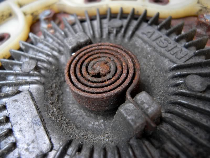

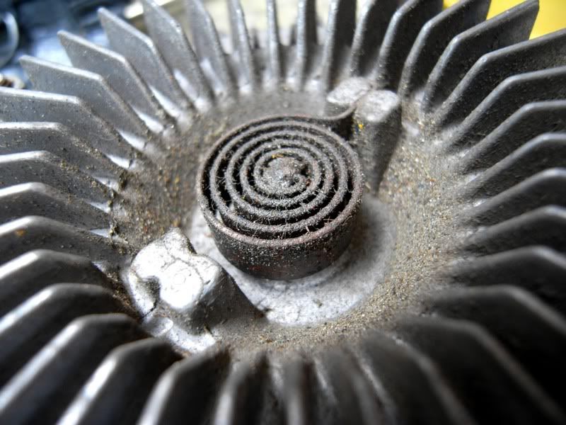

Then I notice the center "thermostatic spring" is of a very different gage spring steel... hmmmmmm
^^^ That's the SUPRA fan spring...
^^^ ...and THAT's the TRUCK spring... and BOTH are SIMILAR looking AISIN parts... hmmmm...

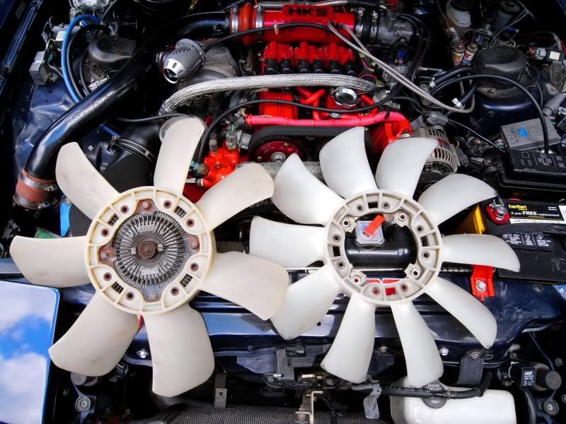

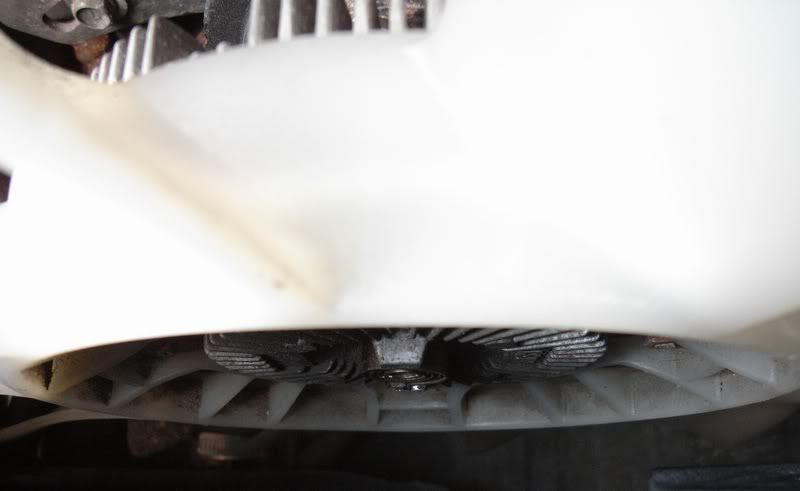

I remove the SUPRA fan from the fluid coupling and place it over the pickup fan assembly to "eyeball" it for size. LOOKS LIKE A FIT!:biglaugh:
^^^ Here you can see the difference between the seven and ten blade fans.
...similar... but different.:icon_surp

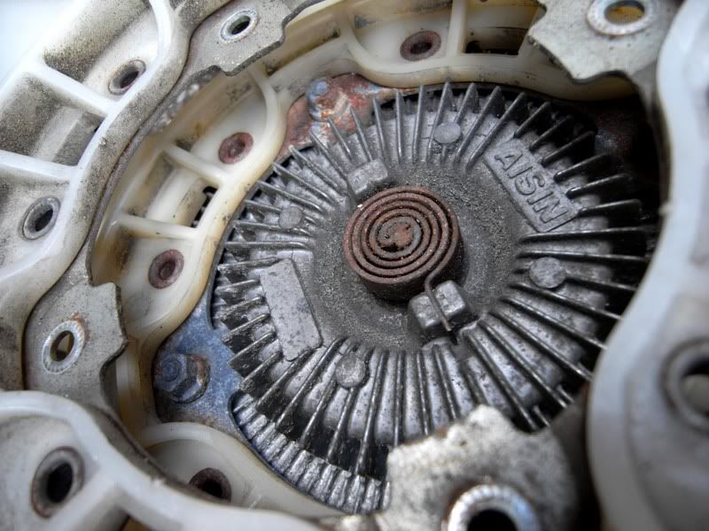

TA DA!!!! (I GROUND the "crimped" spring retaining housing "tabs" down with a Dremel tool... and PRYED the thermosprings from their respective fluid couplings... then SWAPPED the LIGHTER gage one into the TRUCK fan housing... which was in decent shape... (GOOD bearing, anyway!)
After putting the supra spring into the pickup fluid coupling... I took a standard tip screwdriver blade to the spring retaining tabs and gave it a couple good WHACKS!!! to "lock" the spring in position.
...I did such a "GRINDY" job of it... I didn't take any photos of the carnage... except this TOP/DOWN view that doesn't show my WORK!:nono:

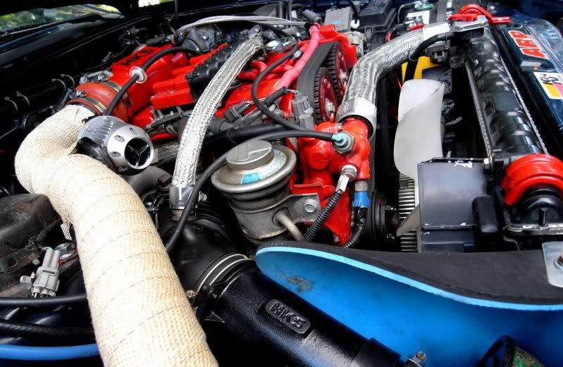

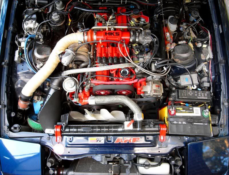

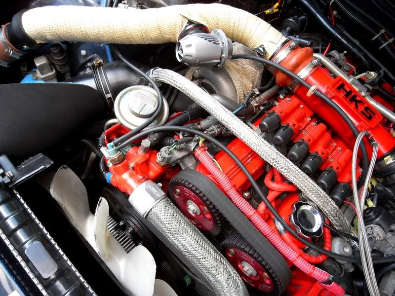

^^^ Oh, yeah... I had some WRAP-STUFF left laying around from the turbo swap awhile back... and since the IC pipe over the turbo gets SOO HOT all the time... I decided to try wrapping it. Here's what I ended up with.:icon_surp
Nothing too fancy... and I couldn't tell you if it is a "noticeable difference"... but it IS incremental, at least.;)
...now we'll see how long 'till it gets real dirty looking.:nono:

Damn did you wrap the whole turbo?
Yup... did that during a recent "turbo swap" when my previous hybrid began to blow some oil past the rear seal. I left the turbo heat-shield off... and went with the wrap as an experiment. My EGT meter began to show MUCH better retention of heat when running hard, so I had less "drop-off" from driving "transients" in load and speed. If I understand correctly, this would be the desired outcome, more consistency in the temps, and better "dissipation" of the heat out of the exhaust.
http://www.supramania.com/forums/showthread.php?t=47656
^^^ There's the TURBO SWAP post.
...I may look at wrapping the downpipe some day... just to see what FURTHER diverting the heat on down the exhaust system will do.
