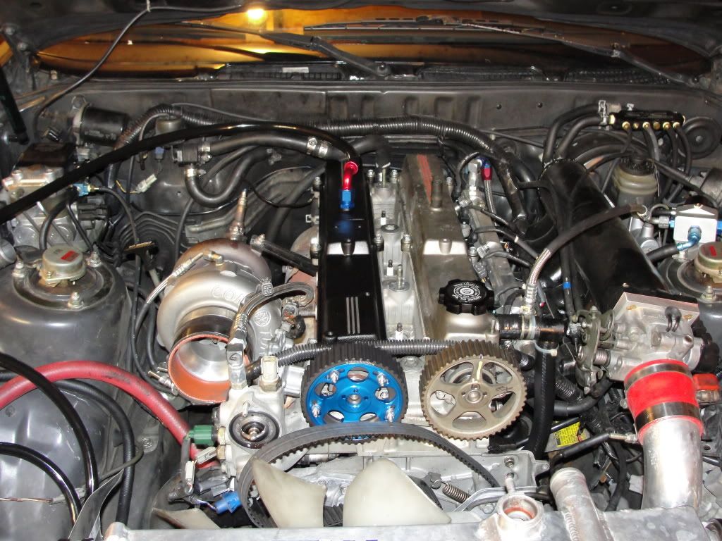

For what its worth, I came up with a elegant solution for that vent line, and its adjustable to fit many diff. configurations.
I used 3/4" oil resistant hose to connect to the block and valve cover vent fitting, then added a 90degree 1" PEX pipe fitting to do the turn.
It can pivot and the hose will flex a bit to give clearance- I'll find a pic if I have one :)

Fredde- I like that routing because you can turn the 90deg fitting to avoid the alternator- I've tried it with dropdown brackets and it works out decently. :)
