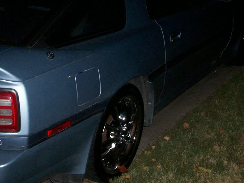

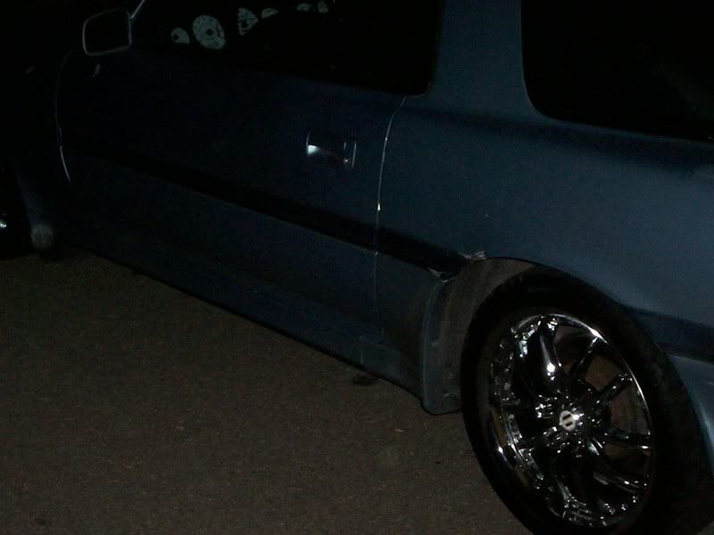

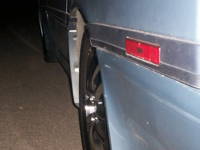

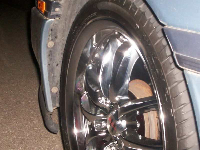

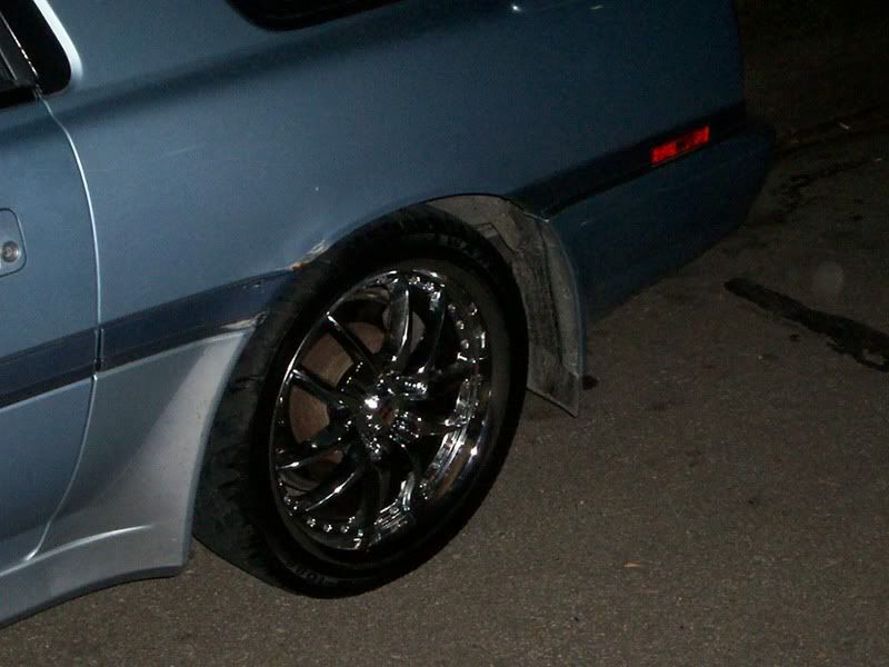

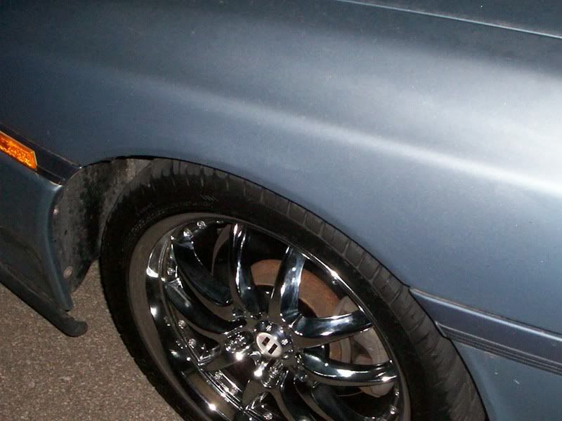

ok so I just bought these 17's from a mechanic at work, but they are a little small offset wise...but it was such a good deal that i couldn't pass it up (i.e. 200 bones for all four with brand new tires and tuner lugs included).
Anyways they don't sit out as far as I would like so I'm probably gonna get some wheel spacers, and also the tires are only 215\40\17. So I'm wondering what is the widest tire I can put on these rims comfortably, rims are 7.5" wide. And also what size wheel spacers will I need to fill out the fender and will I also new longer studs?

Do you know the offset of the wheels? A set of hubcentric spacers would make them sit out closer to where you want to be. I don't know if I would put 245's on a 7.5 inch wheel. With the offset you have they would probably rub. I have 225's on some Mk4 wheels and they rub slightly due to the higher front offset.

Yes, the hub centric spacers would be the way to go. I would guess that 20-25mm should put them out where they will look decent. As for the tire size. I'd stay with no larger than 235/40's. Spacers are gonna' set you back another $200.00+
My $.02
