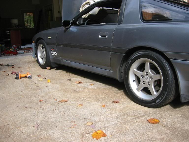

Definitely a nice wheel. Nothing fancy, but it works well.
Well I finally got all my parts in and the trans rebuilt. In the process of reinstalling everything and hopefully driving it tomorrow or Saturday. I had the stock flywheel machined and went with the South Bend Endurance clutch kit. Its just an upgraded pressure plate and full disc clutch. Should be enough hold for me and my plans for a while, and still be very streetable which is the ultimate goal.
