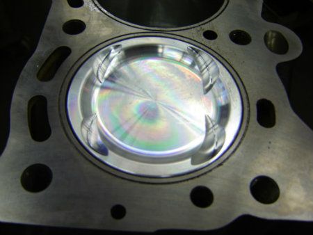

I had a similar situation. I will tell you they exist but o-rings on a 7m isn't a great option.
You can see how little material is left between the cylinders. That being said, I daily drove this motor for a year (on stock boost) without issue.
Unfortunately I can't tell you where the HG came from because I had the machine shop order it.

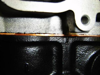

hey, dustin I had my block o-ringed and put a copper gasket on my 7mgte. 3 times. Here is my experience. They wont work for long! Here is what I learned after 3 copper head gaskets and a lot of work and frustration. 1.you have an iron block 2. copper gasket 3. alumunim head. This your problem aluminum temperature changes will make the head break the seal. 3 different metals and 3 different temperatures. Now my copper gaskets were very thick and not able to bend at all. So check with a copper specialist about thinner copper gasket. Solution_ I bought a cometic MLS gasket and some stuff called hylomar. put it on gasket and let it sit over night. put some on the block and bottom of the head. use arp studs and 95ft lbs.
