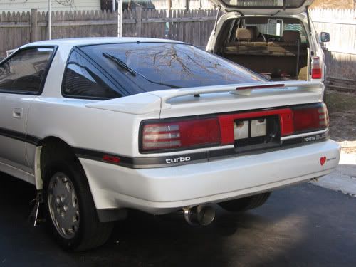

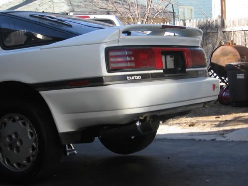

Anyone have pics of the Cooleeze pipes on their car? I want to get a good idea of how low it hangs in the back. I hate low hanging exhaust, anyone got a solution to tuck it right up to the bumper if it hangs low??
