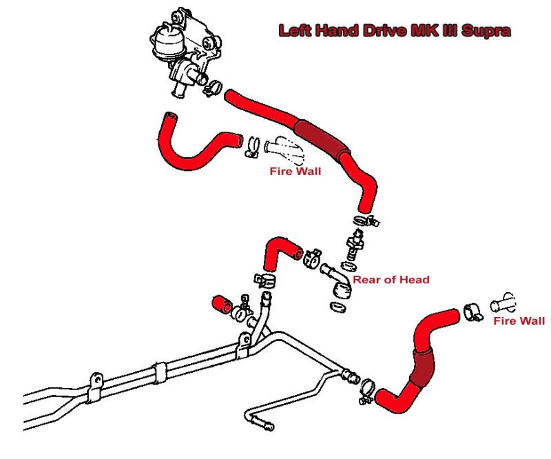

ANYTHING to do with a cooling system failure IS something to be very worried about with a 7M.......
Check the right angle hose on the hardpipe back there for starters.
I wouldn't drive it until it's sorted as you have the potential to do $$$'s of damage.

If that hose is going assume the cap below it, the other 90* hose behind/below the tstat housing and every other heater hose needs to be checked and possibly replaced.

Also check the heater hose that goes along the wall into the head, the 90 deg hose and a cap thats back there. But my bet is on the 90 deg hose or the cap since they are closer to the exhaust. Good luck and let us know what the deal is .....

I had a problem like this a few weeks ago... mine was the hose leading into the head on the back of the motor... i think it went to the heater core control valve... ???? but it swelled and split under the hose clamp... i just happened to be at school letting the turbo cool when i lost heat in the car and was like wtf... i got out and saw coolant and heard a hiss and was like crap.... got it home that night and checked it out... so check that and where everyone else is tellin you... =) hey this could also fix ur heat problem...

There you go! This may help. The UK (Right Hand Drive) model is slightly different.

All fixed it was the 90* bend right behind the head the only problem i have now is the water fall sound behind the dash which i believe you guys said is air in the system so a little more work and were gonna be golden! i drove it last night and it ran perfect other than the water fall sound!
